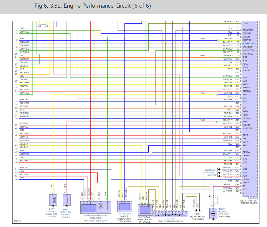

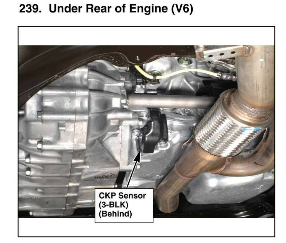

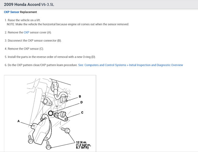

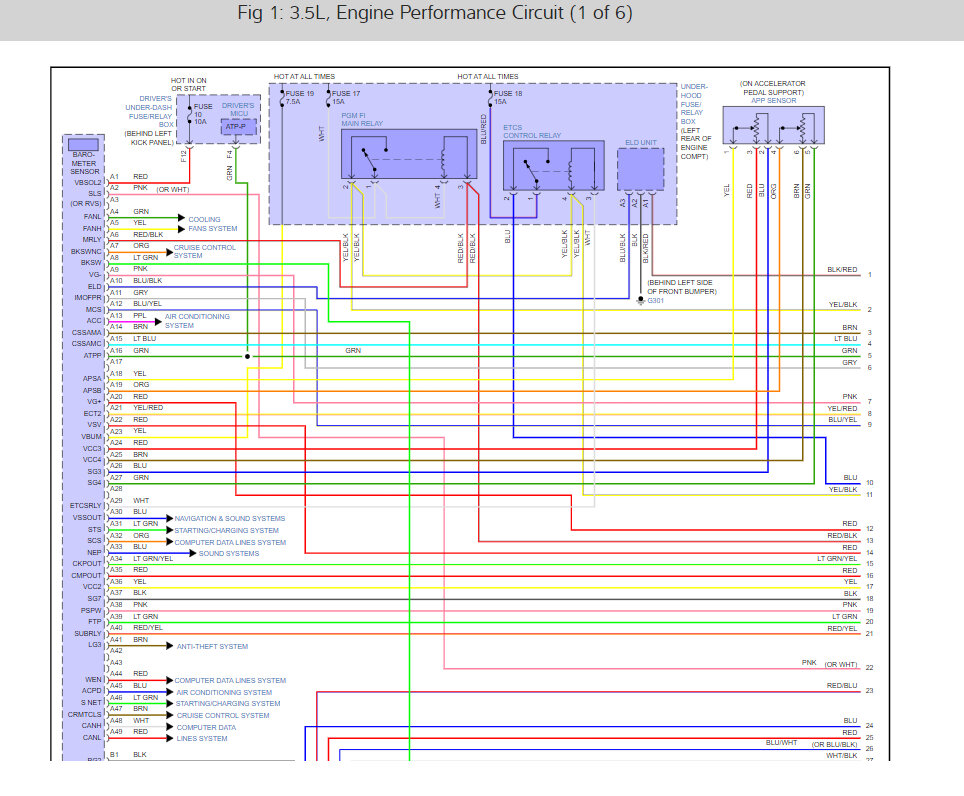

The P0339 code is the Crankshaft Position Sensor “A” Circuit is intermittent. I would check the wiring to the sensor and if okay replace the sensor which should fix the problem. Here is the location of the crankshaft position sensor so you can check it out and replace the sensor. Check out the images (below). Please let us know if you need anything else to get the problem fixed.

Put in the new CKP sensor. It'll start and drive (although it cuts power once i reach 3,000 RPMs, as if that's the redline). But the code comes back immediately after starting the engine. It will often shut off when I come to a stop. What's the next thing to check?

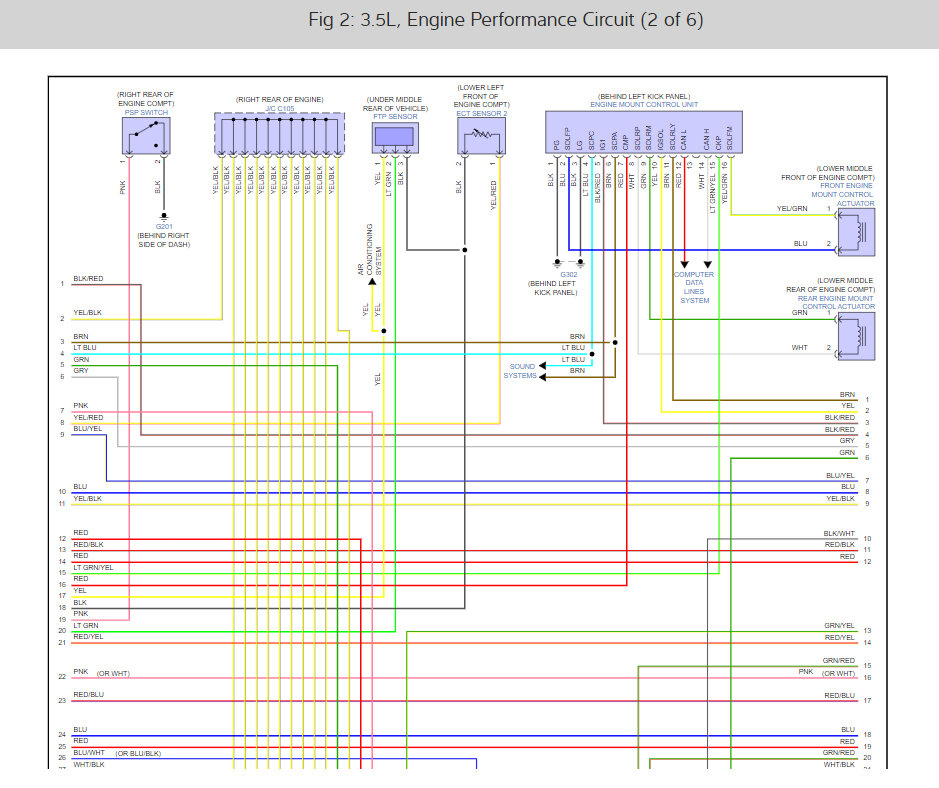

This is the code that comes back?
The P0339 code is the Crankshaft Position Sensor A Circuit

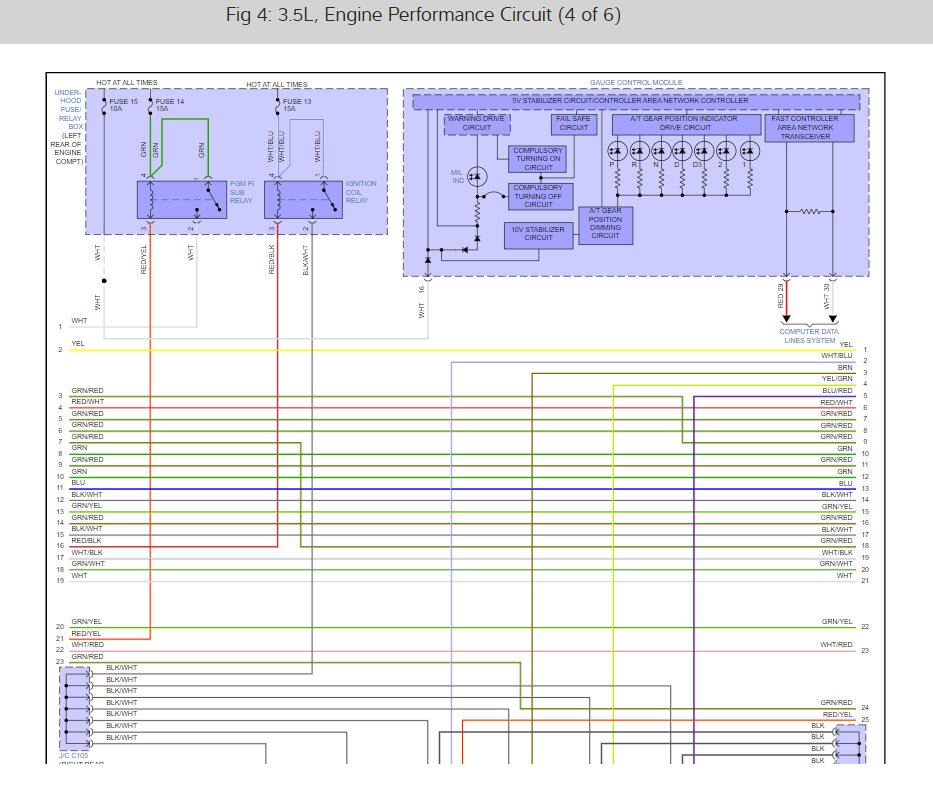

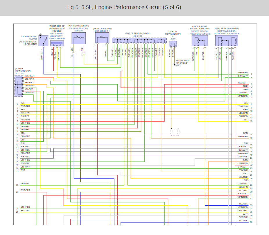

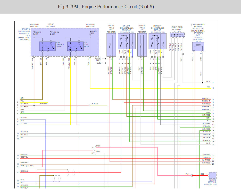

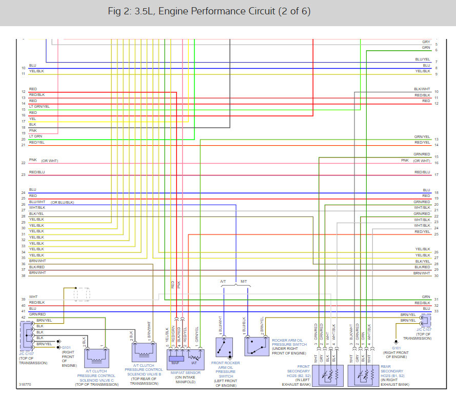

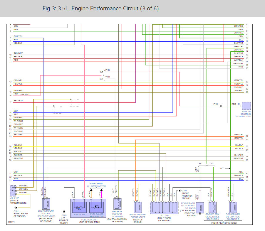

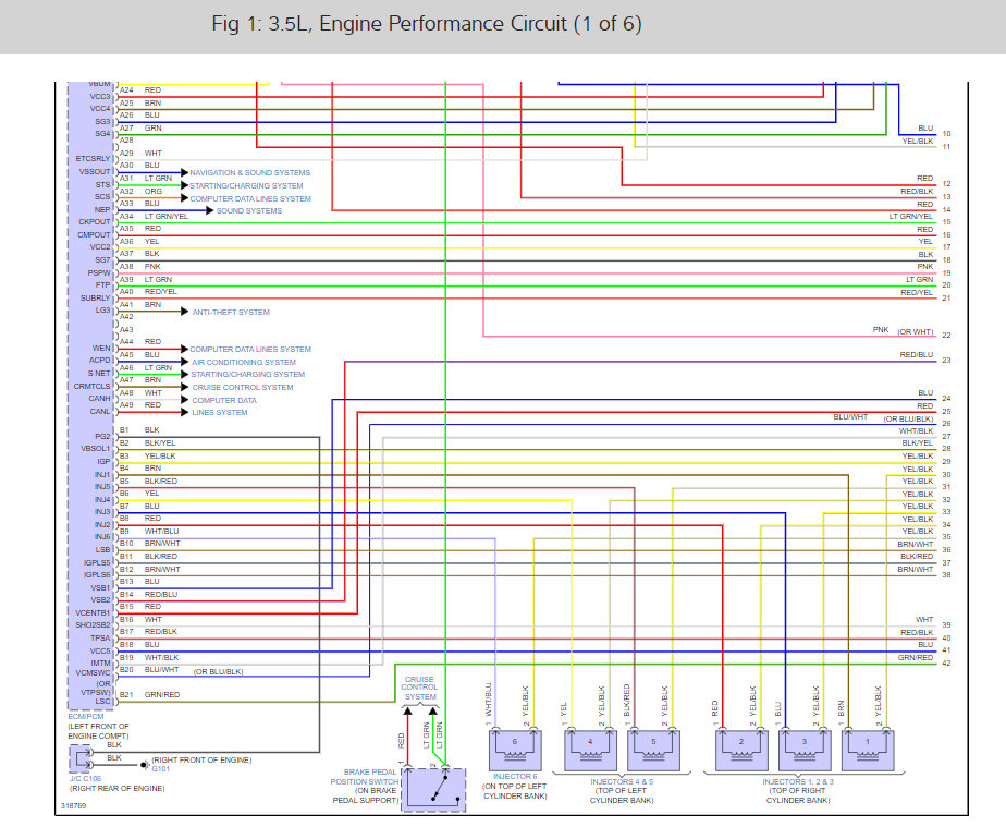

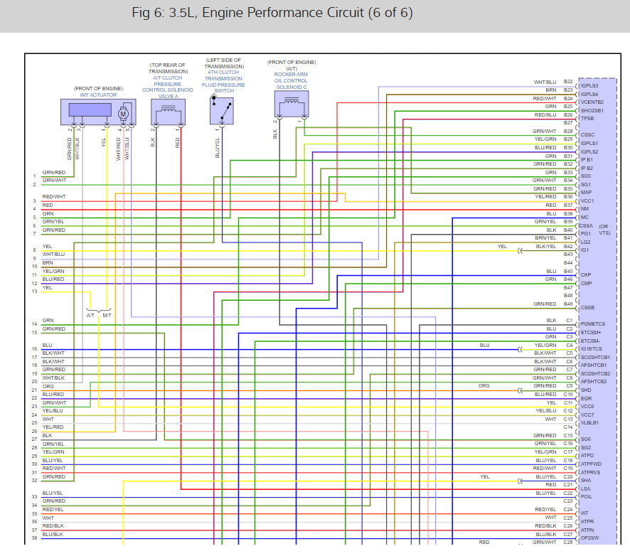

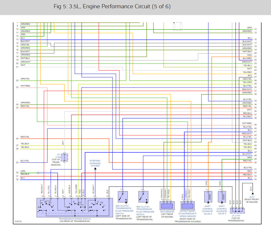

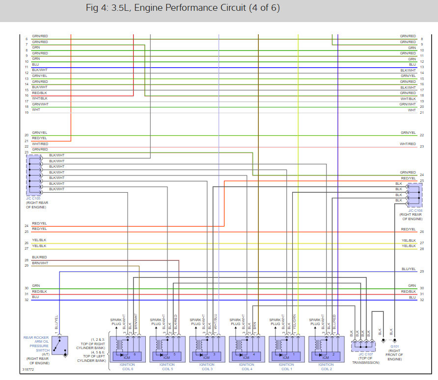

If so, we need to check the connection from the crankshaft sensor to the PCM. here is a guide and the wiring diagrams for the engine and sensor so you can see which wires to test.
start with the last two diagrams which show the crankshaft sensor wiring. Check out the images (below). Please let us know what happens.

It's probably worth noting that I noticed i had installed the new sensor a little bit wonky. After seating it correctly, I reset the codes and fired it up and let it idle for a few minutes. No codes. Come back a little while later, and after driving it for maybe 30 seconds, CEL (p0335) is back on and has the same symptoms as before.
