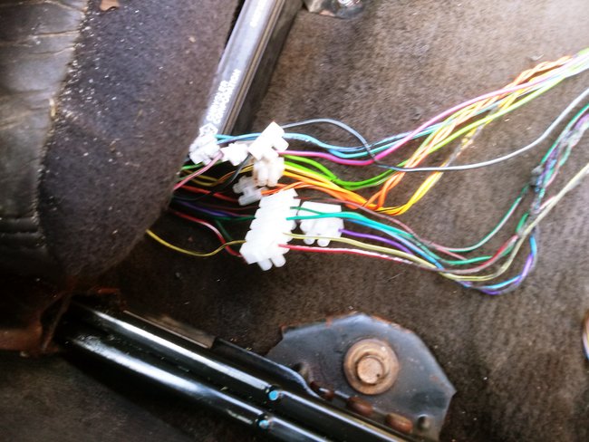

hey,
hope you can help me ;-)
i m writing from Mallorca Spain and I have the car listed above. The previous owner of the car changed the amp into an aftermarket 2 channel amp. Now I have a broken 1999 model for parts with an original amp. The problem I have is, that the amp from 99 has different connectors and more wires than my car has. I reconnected all the wires and it is working but the amp now drains my battery when the car is off and the key is taken. I could nott find the mistake.
Do you have any idea where I made a mistake?
Oh, sorry if I have any writing mistakes. ;-)
try to add a image
Greetings from Mallorca,
Andy

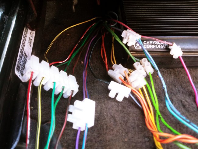

but i removed the aftermarket amp out off the car and installed the original infinity amp.the problem is, that my Sebring is a 1996 model but the amp comes from a 1999 model and seems to be different. i connected the wires from the original amp to the cars wires color by color. so i don´t have any aftermarket supplies inside.
at the cars wires there are two yellow black one´s do you think that this can be the problem?

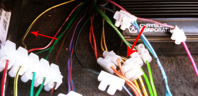

I don't see a yellow/black wire on either the 96 or 99 wiring diagrams. I do see a yellow/blue wire on both. Could these be these wires?

Thanks for answering. i put you the picture again in here where i marked the wires i mean.
those two wires have the same color yellow black or blue. maybe it helps.

Okay, I'm not sure of the question. You have what wires go where for both vehicles. Simply match the wires from the your 96 and connect them to the wires from the 88 diagram to where they would be going if you where hooking up a 96. If the right front speaker(+) id gray/blue on the 96 and it is gray/red on the 99. then take the gray/blue wire coming from the pin associated with it on the diagram and connect it to the gray/red coming from the connector of the speaker. Repeat this process until all the wires are connected and you are done.
