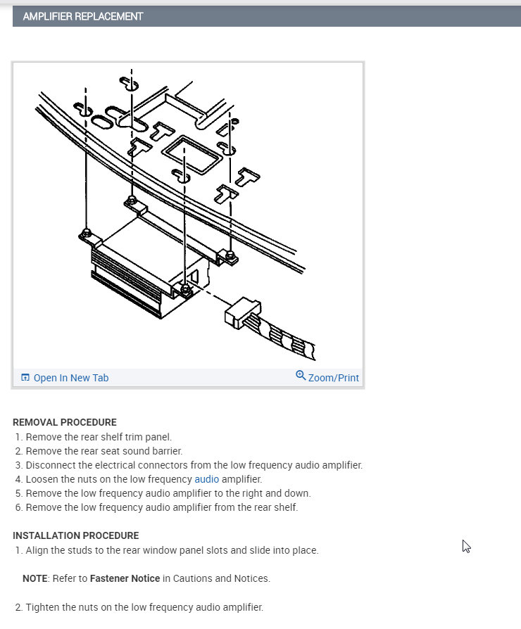

Where is the location of the Amp on the car listed above LS model?
Jul 21, 2019 at 7:46 AM

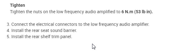

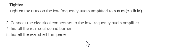

Looks like the Amp is under the rear shelf. Here is the procedure on how to replace the amp.
Let me know if you need more info. Thanks

How do I access the rear shelf where the 6x9's are and the Amp is. Do I have to take the backseat apart to reach them?
Jul 26, 2019 at 8:35 AM
Probably not. Look in the trunk and see if you can access it from there. I attached the instructions earlier and it says to remove the trim and then sound barrier. More than likely this is from the trunk.
