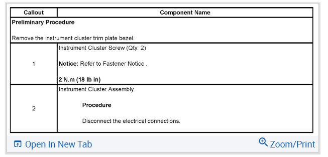

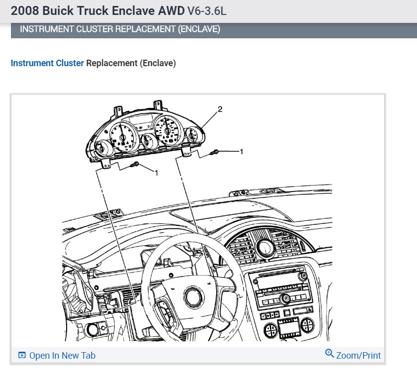

speedometer and tachometer lights work but the small gauges go out after a short bit. just wondering if you have come across this before i have to pull out the cluster?
Jul 9, 2019 at 9:39 AM
  • 55,224 POSTS
Yep, it sounds like the cluster has gone bad. here is a video of the job being done in a similar vehicle and diagrams below to show you how on your car:
https://youtu.be/_HEC44xENxw
