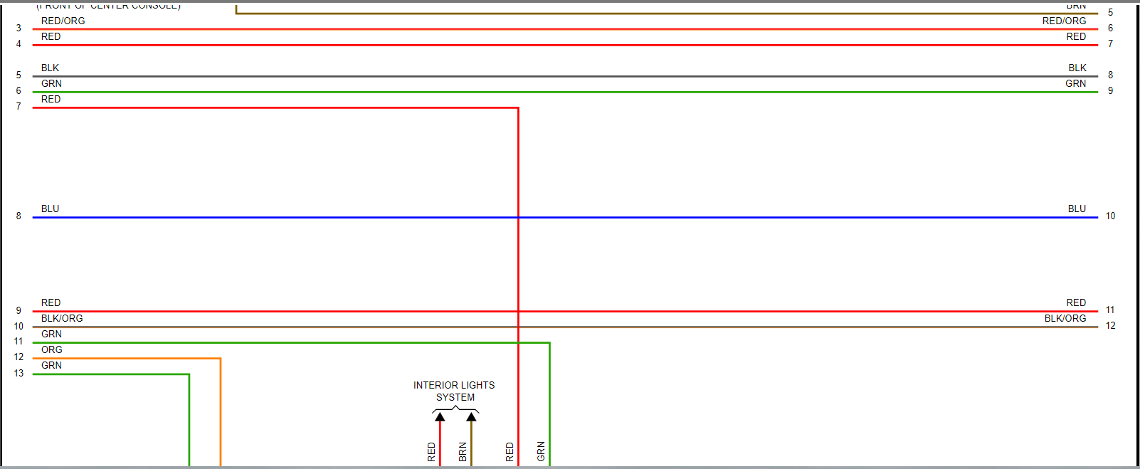

BUZMAN23

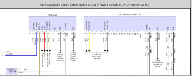

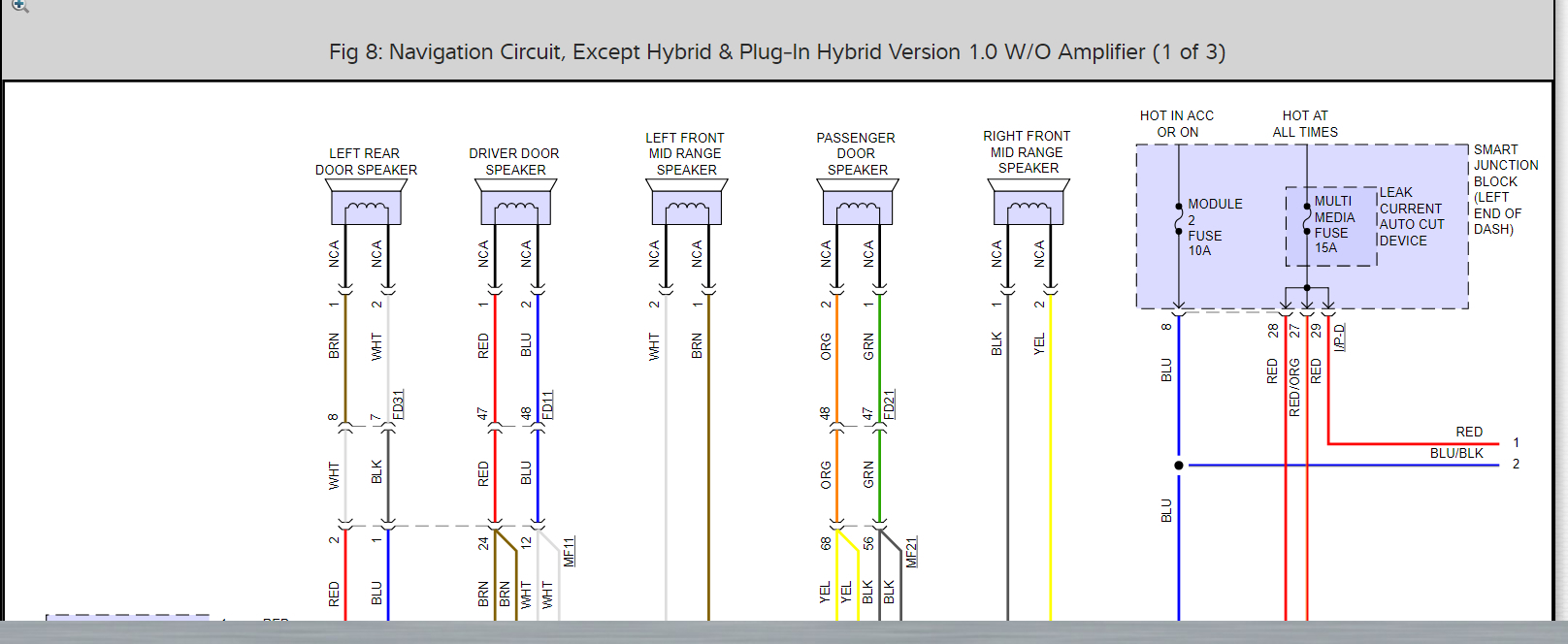

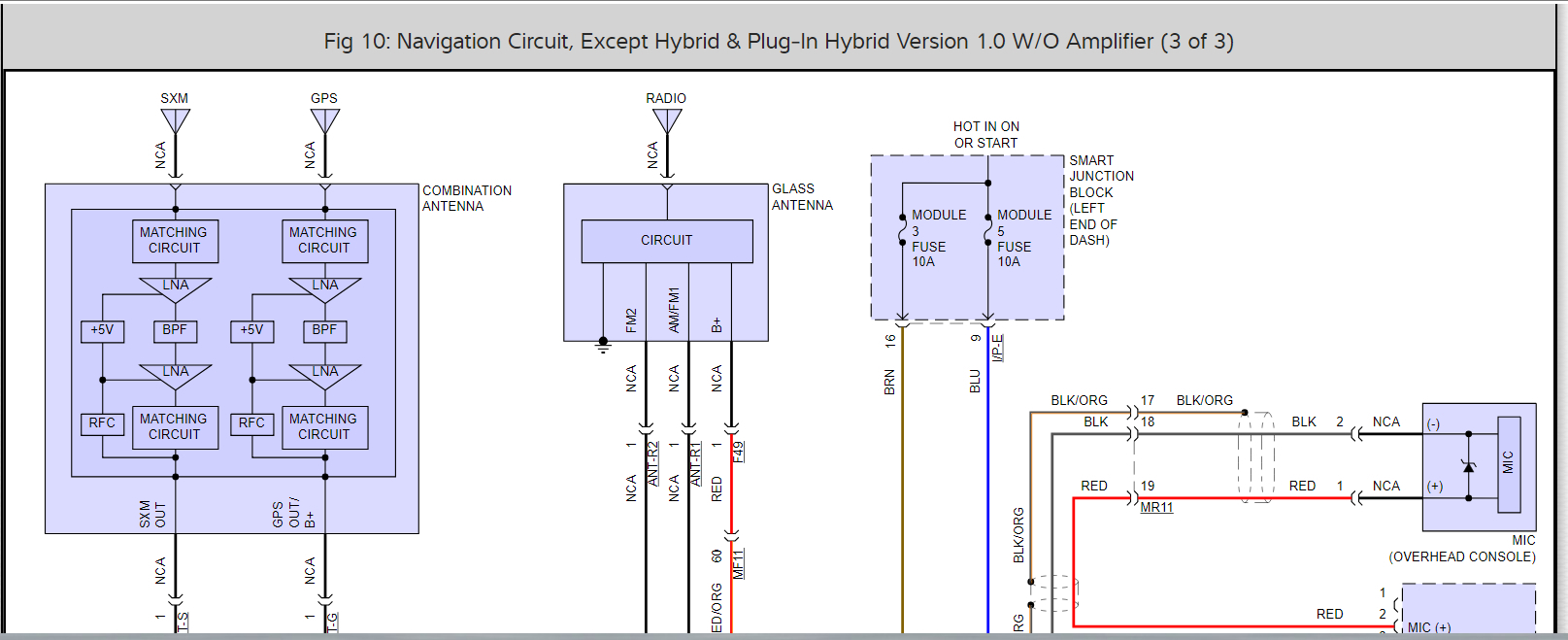

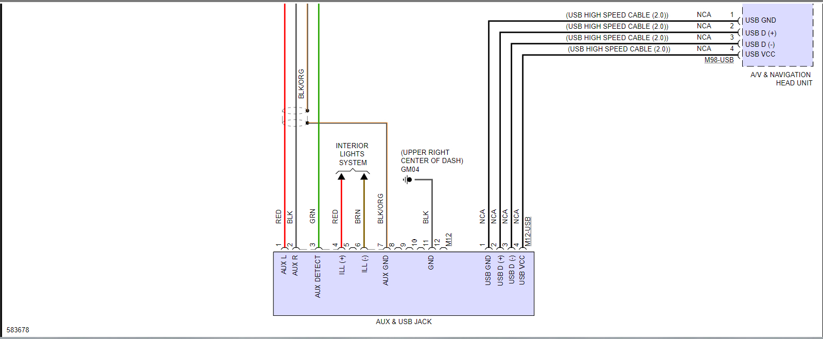

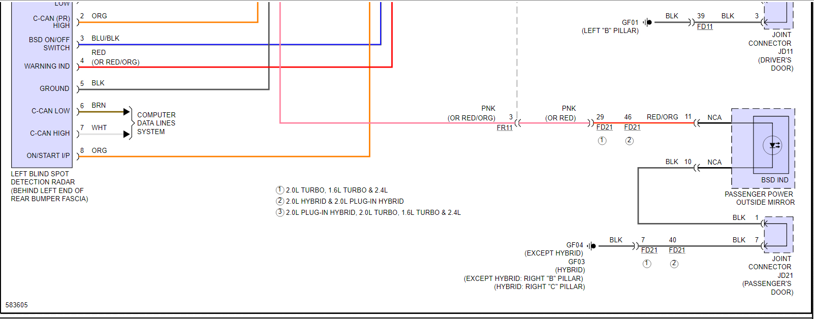

I am looking to add an aftermarket amplifier and sub-woofers to my car listed above EX model. Are there wiring diagrams available so that I can properly choose the wires with which to hook up the amp? I will be using a line out converter if there are no available RCA outputs.
Mar 5, 2019 at 12:55 PM
SCGRANTURISMO
  • 4,897 POSTS

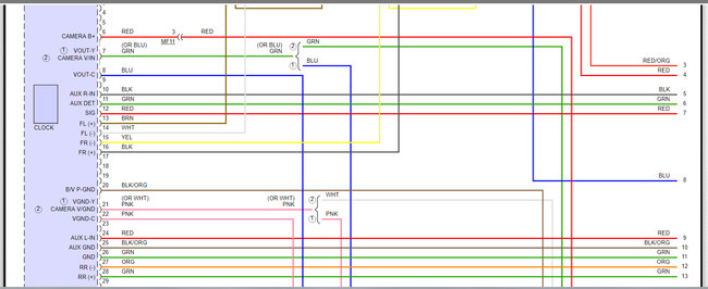

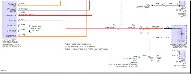

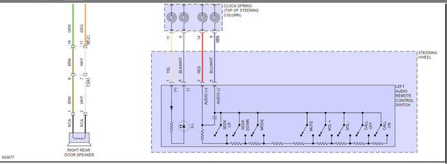

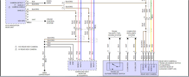

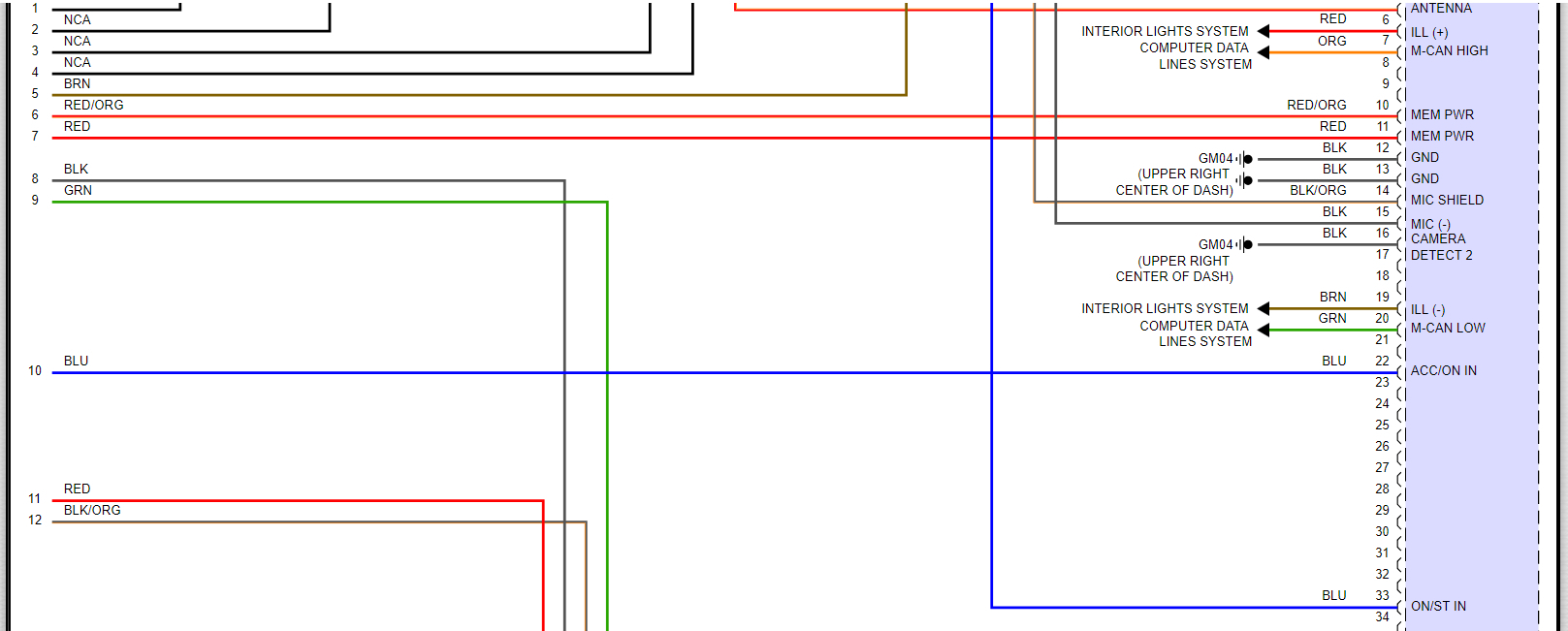

I have all the information that you requested in the diagrams down below. If you need any more wiring diagrams or just have any other questions or concerns please feel free to get back in touch with us.
