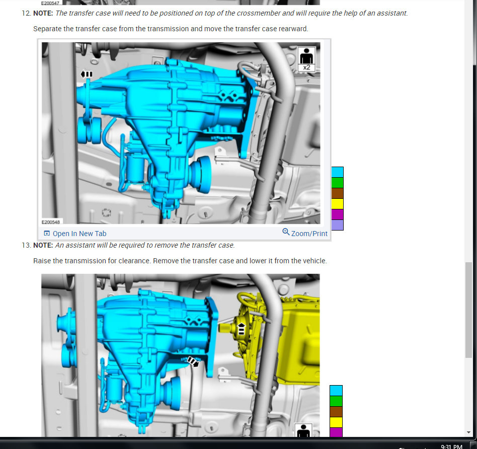

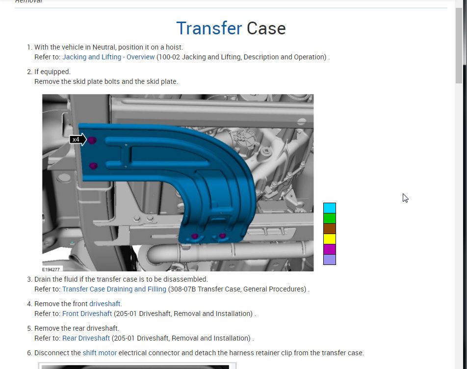

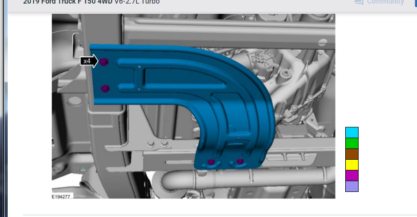

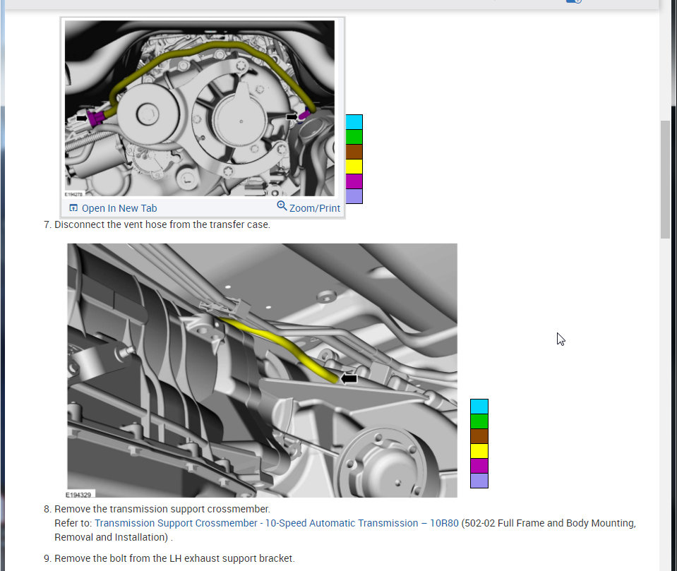

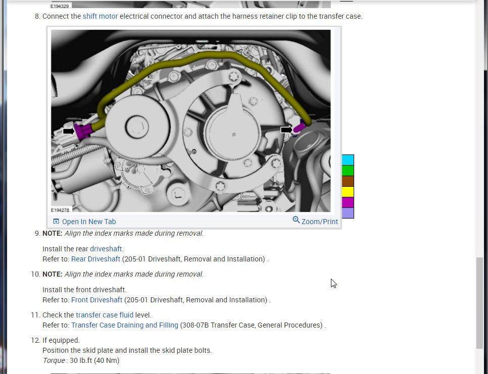

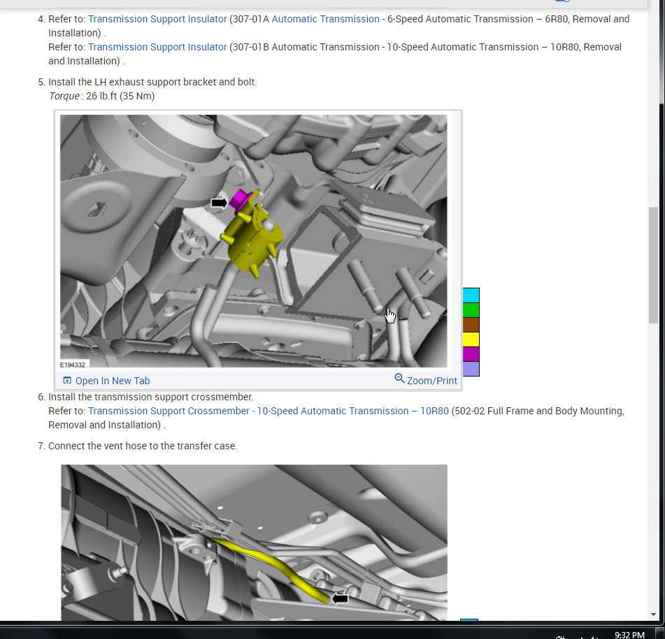

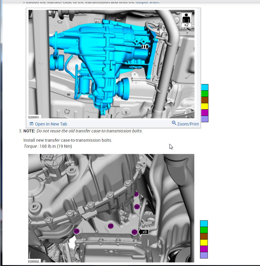

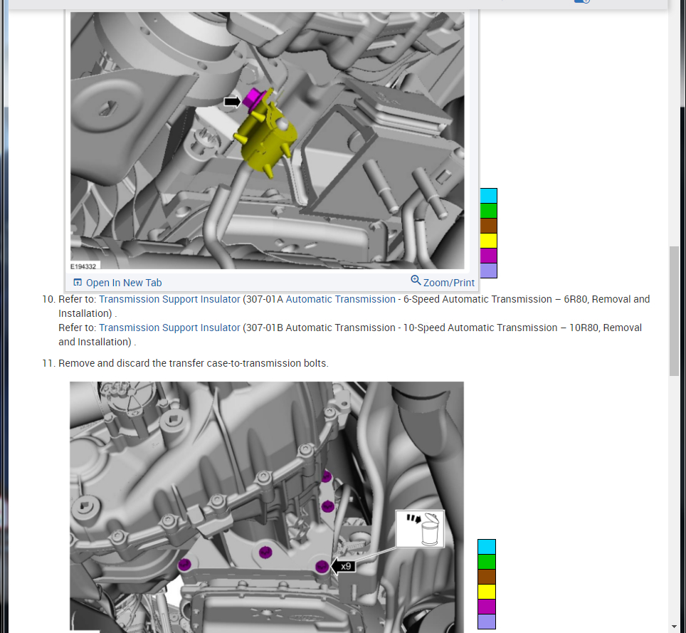

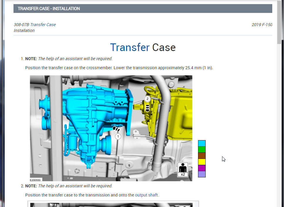

Do I need a transmission jack to change out the transfer case, can you please give me instructions?Thanks!
Tuesday, May 19th, 2020 AT 3:27 PM
MECHANIC
18,907 POSTS
You do not need to support the transmission as you will leave the crossmember in place that will keep the transmission in place.
I attached the entire process below. Please review this material and let me know if you have questions. Thanks
