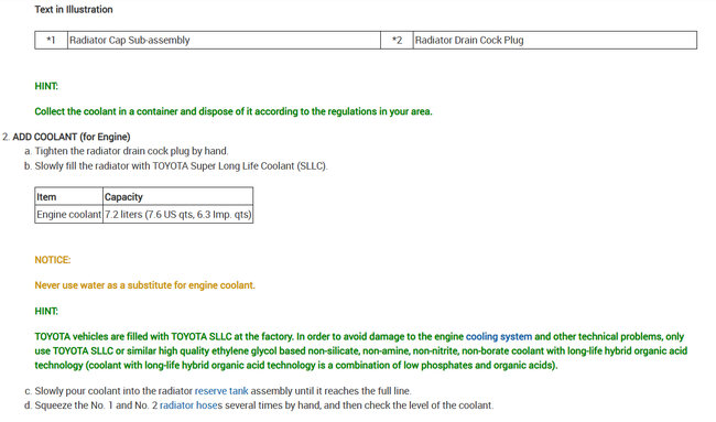

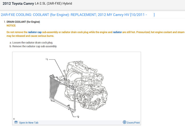

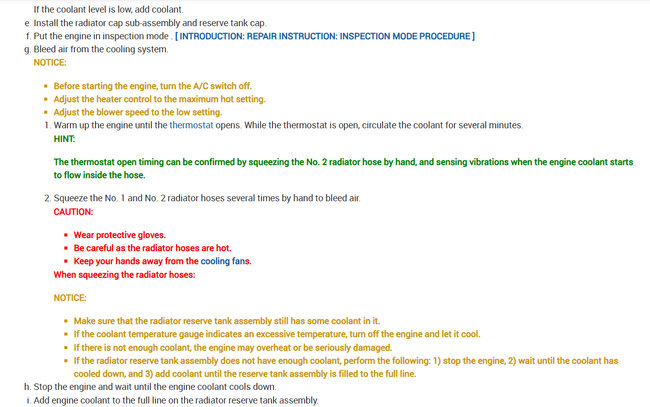

The engine's cooling system has a total capacity of approximately 7.7 quarts (7.3 liters). Here is a guide to help you service the system with instructions to do the job on your car in the images below.
https://www.2carpros.com/articles/coolant-flush-and-refill-all-cars
Toyota recommends using Toyota Super Long-Life Coolant (SLLC). Check out the images (below). Let us know if you need anything else.

1. once i bleed the radiator and reservoir and want to replace them the amount that i will add will be less than 7 liters as i know there will be coolant remaining inside the engine, right?
If yes, how i can bleed the engine coolant? Is it necessary?

Yes there will be coolant left inside the engine block. You don't need to bleed the system just go over the guide in the post above. Please make a new post for the inverter coolant.
