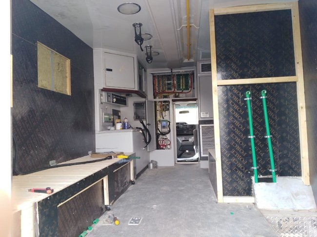

can i add on-off switch connect to the main switch power and use solar power inventor 5000 watt or 12v generator

Since all lights and air condition and refg doesn't operate when the switch is off does any body know how I can solve this problem? I converted to RV I need travel. can i add on-off switch connect to the main switch power and use solar power inventor 5000 watt or 12v generator? so i can use the utilities when I am in dessert or else what other options? especially i understand rear air-condition could be no way to use it when switch is off. This is an ambulance converstion.
Thanks

Sure you could. I wouldn't hook it to main power switch, though, I would buy a bus bar and then run wires from the bus bar to the components that you want to power with the power source. Put the on/off switch inline in between the power source and the bus bar. I hope this helps.

Thanks Alex, I am trying to avoid putting more wires because the car is already loaded with punch of wires. usually when am driving I don't need the power inside. I needed only when I stop in places for one or two days. can I cancel the main switch and hooked to solar invertor or other wise I will follow your advice. but how I can solve the rear air-condition when engine is off or I have to buy external air-condition especially am trying not to make holes in the sailing .

Yes you will either have to buy an external Air Conditioning Unit or idle your vehicle's engine. In order for your vehicle's A/C to be on the engine has to running. I hope this helps.
