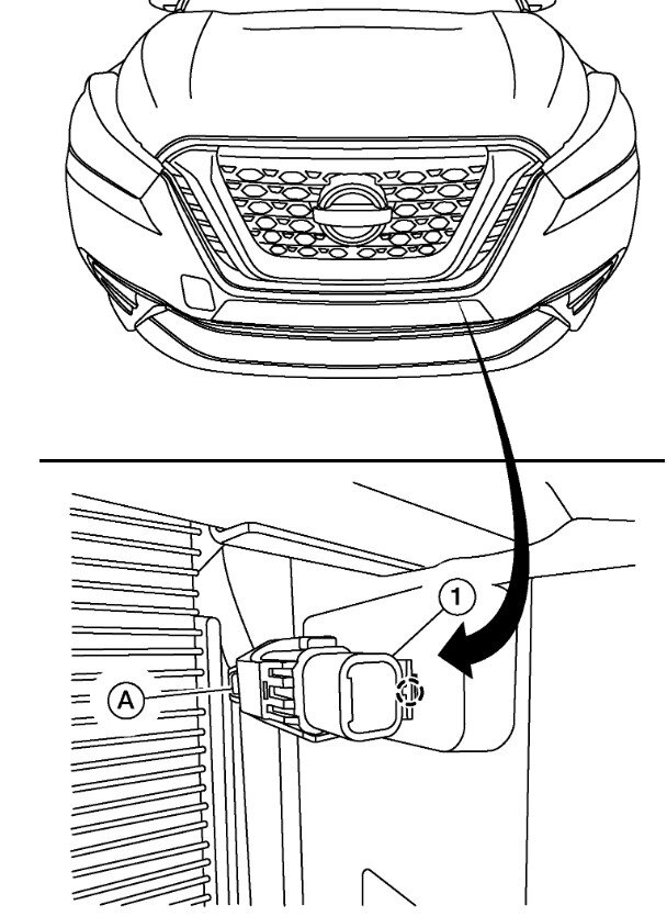

Where is the Ambient Temperature Sensor located?
2019 NISSAN KICKS
95,000 MILES • 1.4L • 4 CYL • 2WD • AUTOMATIC
CRAIG M
  • 16 POSTS

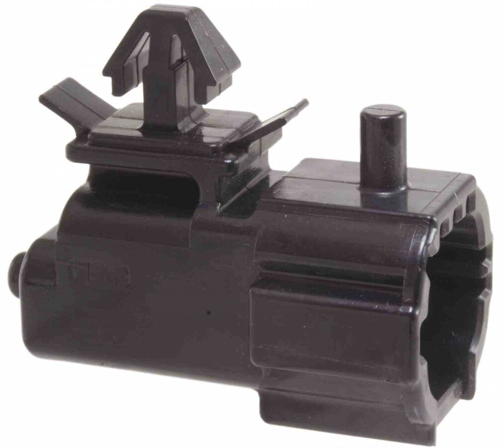

My stepdaughter had a small collision with a small animal that affected her air conditioner. The body shop fixed the front-end damage, but the A/C only works part time. I noticed the ambient air temperature sensor was reading 20 to 30 degrees cooler than the actual temperature. I looked underneath the car and saw the temperature sensor hanging in over the bumper guard. The sensor was attached to a broken piece of plastic. I’m trying to find out where the sensor was originally attached.
Jul 4, 2025 at 2:16 PM
STEVE W.
  • 15,344 POSTS
It should go into a pair of holes in the support behind the bumper up near the A/C core. The image doesn't show it really well but the tabs squeeze in and you can remove it from the broken plastic. Then put it into the correct spot. Ideally it is there so it is in "dead" air so it can get a true reading. If it hangs loose out in the air going under the car it will read incorrect.
Jul 5, 2025 at 1:04 AM

Thank you very much. I’ll have to look to see if the attachment piece was replaced.

I found out the price it was attached was broken and not replaced. I replaced the part and was able to get the ambient air sensor replaced. However, that was not the real issue. The ac will sometime work for anywhere between 10 minutes to 2 hrs and then the fan quits blowing.
