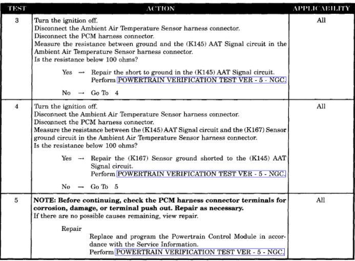

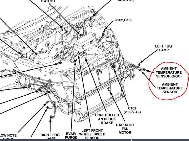

I am trying to find out where the ambient temperature sensor is located.
Sep 16, 2020 at 11:15 AM
DANNY L
  • 5,648 POSTS
Hello, I'm Danny.

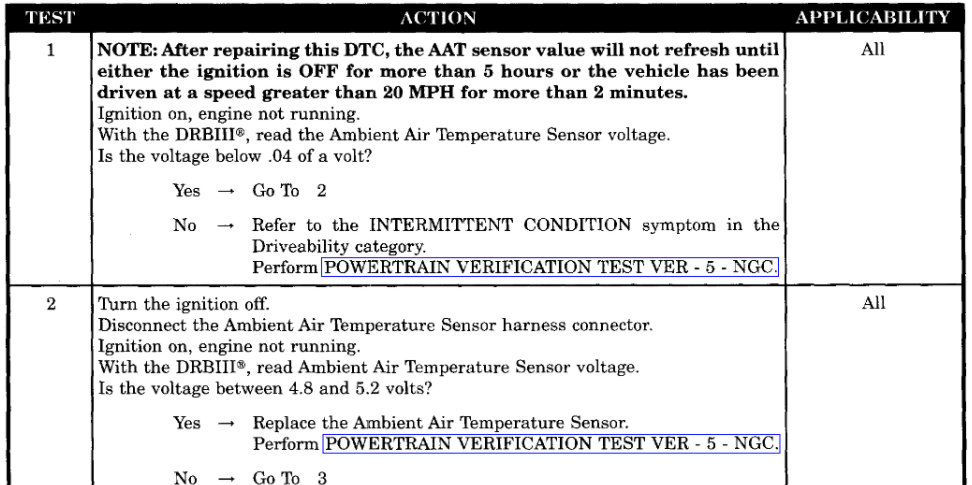

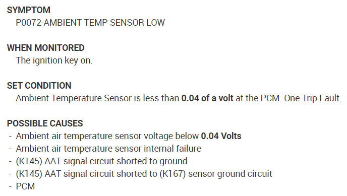

I've attached a picture below and circled in red the location of the ambient air temperature sensor you requested.It's on the front left side. I've also attached diagnostic steps below for that particular code.Hope this helps and thanks for using 2CarPros.
