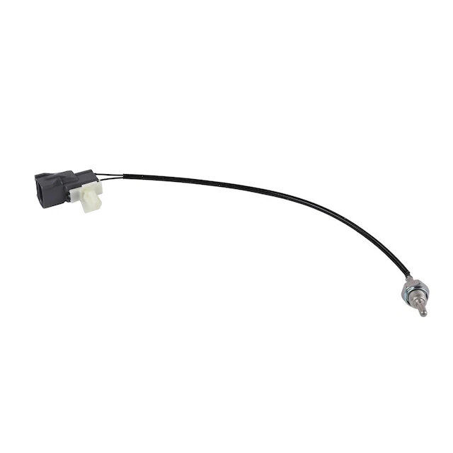

Thank you for your response. I am talking about the HVAC one. I have a Scangauge III attached, and one of the metrics it reads while driving is ambient air temp. Lately, it has been reading very high numbers like 150° ect. Its certainly not that temp outside. When it reads that, the AC will shut off intermittently, usually while traveling through the desert on a hot day. I'm figuring the AC is turning off to save the engine from overheating because it thinks its hotter outside than it actually is. I purchased part #25775833 (ambient air temp sensor) to swap it out to hopefully show the correct temp on the gauge, and to allow the AC to work when I need it to.

That type was used on some of the versions depending on the options. A quick way to tell would be to look for option DF5 on the RPO sheet in the glove box. If it has it they were in the top front center of the core support near the latch. So there are some out there that use that part (Believe it's on the conversion or HD units like cab/chassis for ambulance and such)

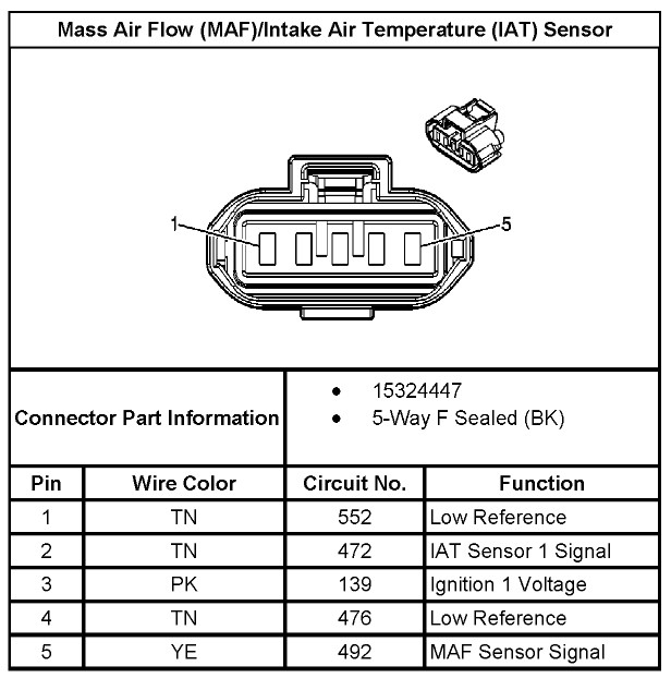

The Intake air Temp Sensor is part of the MAF sensor in the intake path, it's a tiny thermistor that sets next to the hot wire. That is why there are 5 wires. Pins 2 and 4 are the IAT One side is grounded and the signal changes based on the temp of the air passing by.

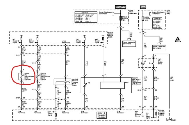

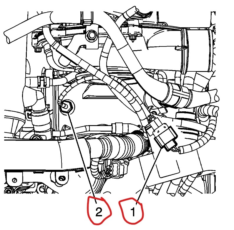

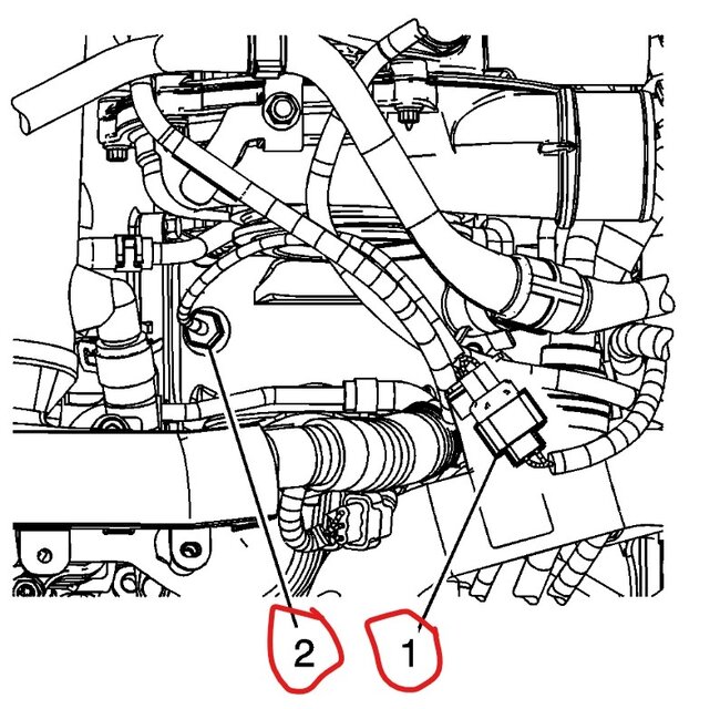

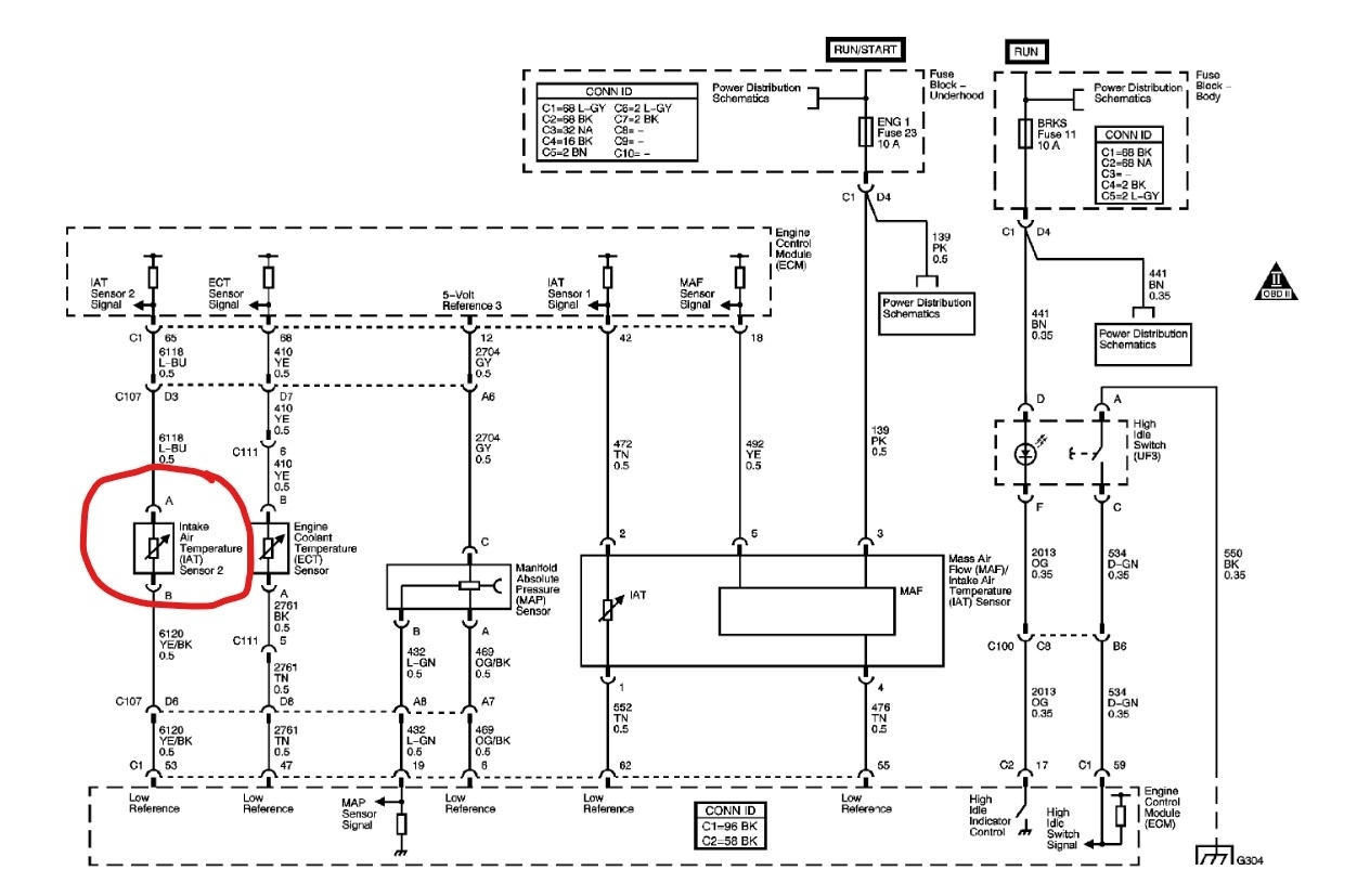

BUT GM played a trick on the diesels and uses 2 intake temp sensors. It uses the signal from sensor two for the HVAC as well as to compare to the IAT in the MAF. It's in the intake manifold below the air intake duct on the top of the engine. They usually stick in place pretty well. That is it in the last image. FYI, the changing readings are commonly corrosion in the connector itself. It's on top in the harness. Hope that helps.
