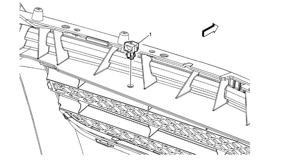

Sometimes 60 degrees or more. I have changed the sensor as well as the connector with no change. What else could be causing this?
Mar 21, 2019 at 7:27 AM
Good afternoon,

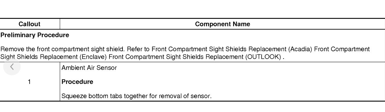

Where was the location of the sensor you replaced? there are two sensors. One for outside temperature and one for inside temperature.
Mar 21, 2019 at 9:05 AM
AJFOSTER
I replaced the outside sensor and connector.
Mar 22, 2019 at 3:47 AM

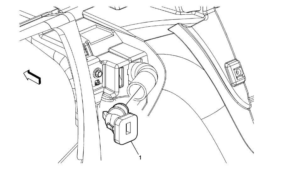

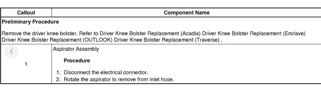

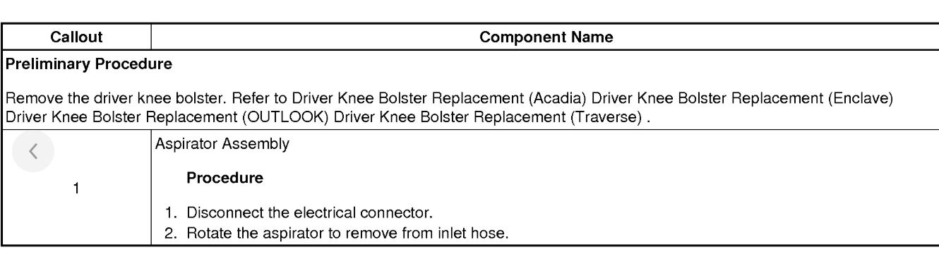

You need the inside sensor. That is the one reading wrong.
Mar 22, 2019 at 4:24 AM
AJFOSTER

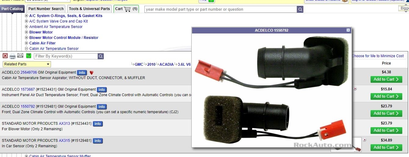

So the inside sensor controls the display for the outside temperature? What is the part called specifically? There are three inside climate control parts listed on rock auto.
Mar 23, 2019 at 12:00 PM
They work together on temperatures.
Cabin air temperature sensor.
