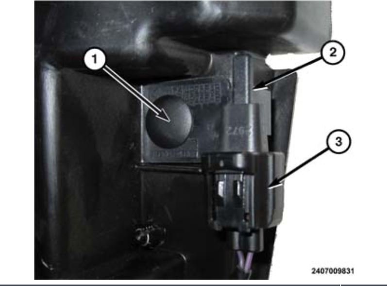

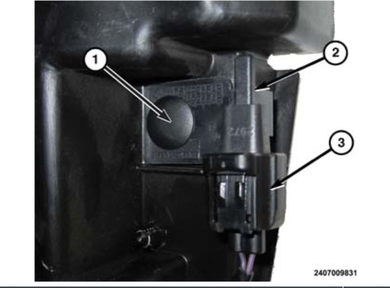

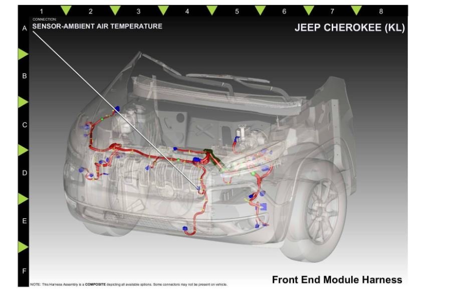

Where is the outside ambient sensor located at?
Mar 6, 2019 at 1:00 PM
Good afternoon,
It is behind the grille at the front of the truck. I attached a picture for you.
1. Disconnect and isolate the negative battery cable. If equipped with an Intelligent Battery Sensor (IBS), disconnect the IBS connector first before disconnecting the negative battery cable.
2. Disconnect the wire harness connector (3) from the ambient air temperature sensor (2).
3. Remove the push pin (1) that secures the ambient air temperature sensor and remove the sensor.
