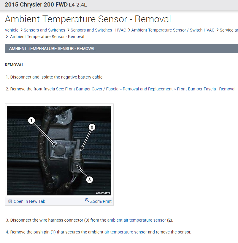

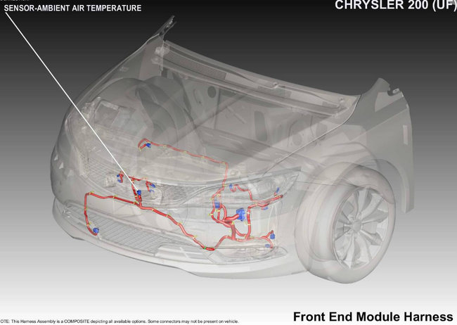

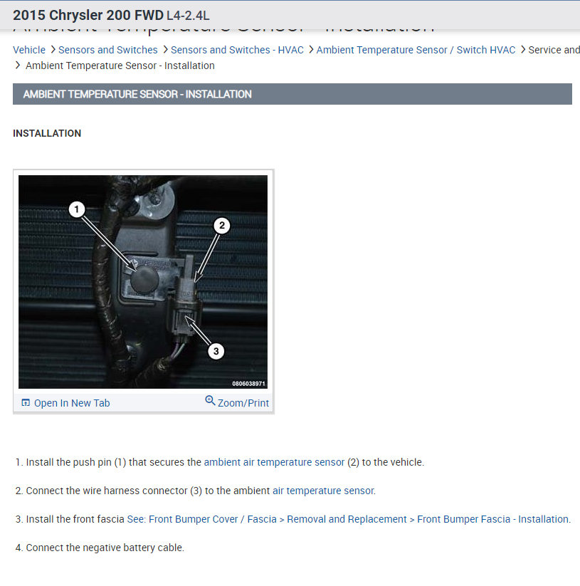

can't find the ambient air temperature sensor.
Sep 2, 2021 at 2:15 PM
SQM
  • 6,383 POSTS
The ambient air temperature sensor is located right behind the front grille.
I have attached diagrams and pictures for your reference.
