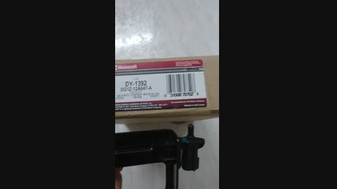

Hello, I need help locating the ambient air temperature sensor (DG1Z-12A647-A). Thanks

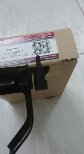

MWAKID
This is the sensor for outside air temperature.
The reading of the outside temperature shows (-- --). I bought the sensor from the dealer (shown in the video), but don't know the exact location.
Jun 22, 2019 at 7:39 AM
I cannot find a picture for you but it is in the front on the radiator support. It may be when you open the hood mounted on top of the radiator support or it could be at the bottom by the front bumper cover.
