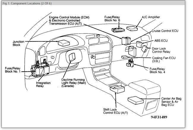

AM2 fuse blows every time when I put it in gear. Can anyone help?

That fuses feeds the ignition switch which I traced down to the Shift Lock ECU is the only thing that can be causing it. It is located in the center console check it for water damage.
Check out the diagrams (below). Please let us know what you find.
