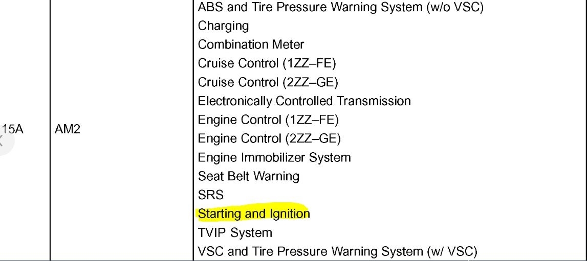

What components are powered by the AM2? What else should I check/pull to find this dead short?

The AM 2 fuse is for ignition and fuel and a few other things. I suspect that if you remove the AM2 fuse and replace the main fuse, the starter will engage.

I attached a pic below that shows what this fuse powers. There are things in the list specific to engine model.

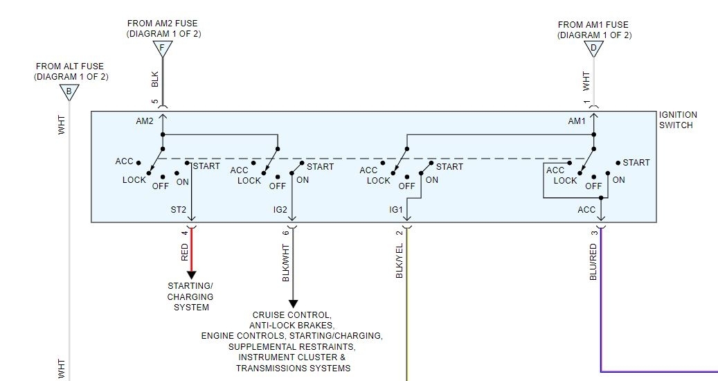

If ignition is in the ON position , fuse blows , this leads me to believe there is a dead short. What circuits feed off of this? I’ve searched in vain for this info along with the pin out of ignition switch to see if there’s a wire hot that shouldn’t be.

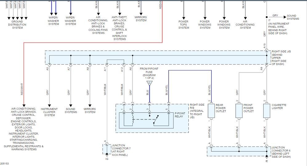

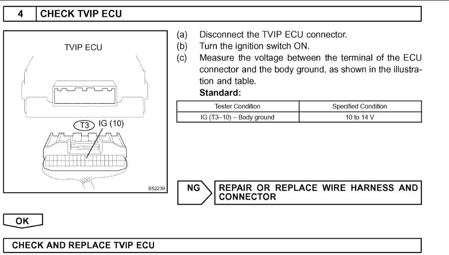

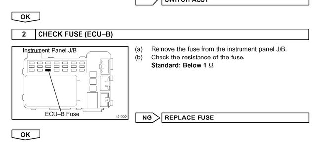

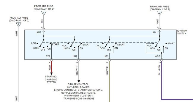

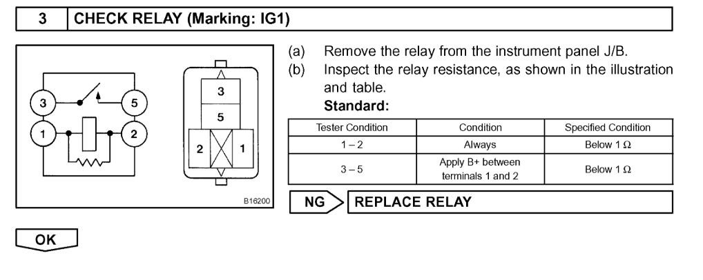

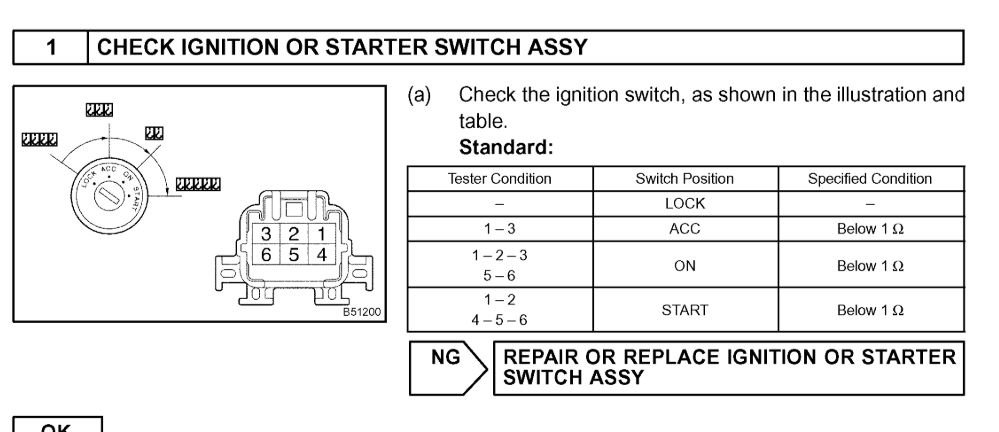

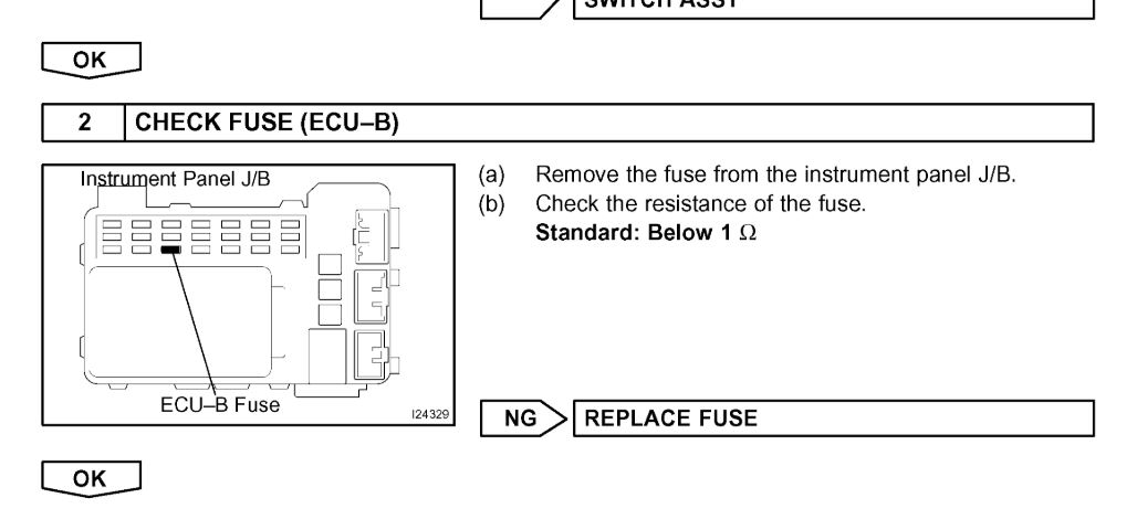

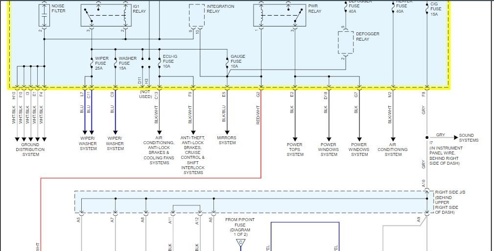

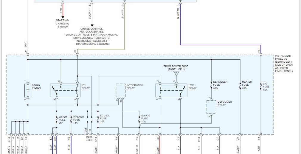

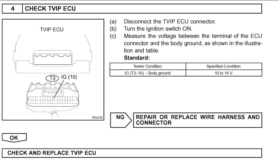

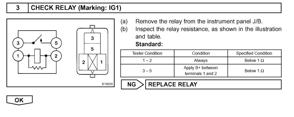

I attached a few pictures below. The first 4 are the test procedure for the ignition switch. They show what each pin should have as far as resistance.
The last four pictures are a schematic showing power to the switch and power out. I overlapped them so you could read them.
Let me know if this helps.

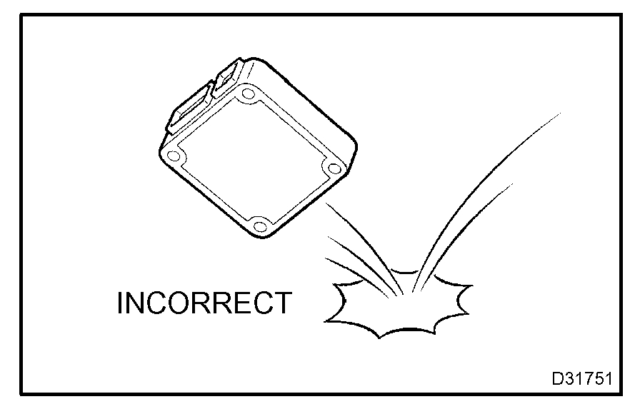

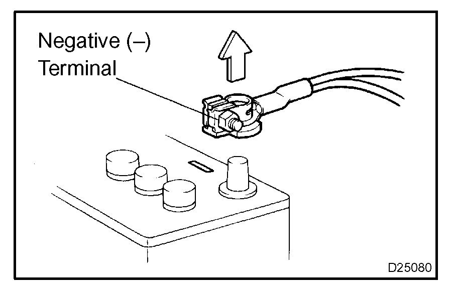

pic 1
a. REMOVAL AND INSTALLATION OF BATTERY TERMINAL
1. Before carrying out any work on the vehicle electronics, disconnect the battery negative (-) terminal cable to prevent component and wire damage caused by accidental short circuits.
2. When disconnecting the terminal cable, turn the ignition switch and lighting switch OFF and loosen the terminal nut completely. Perform these operations without twisting or prying the terminal. Remove the battery cable from the battery post.
3. Clock settings, radio settings, DTCs and other data are erased when the battery cable is removed. Before removing the battery cable, record any necessary data.
