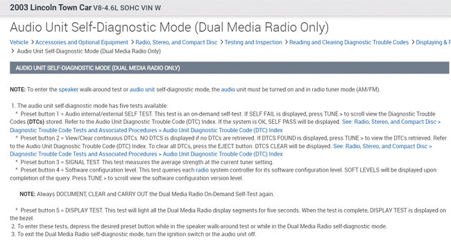

If you get static when the engine is on or off, and it works properly when changed to AM stations, it sounds like the radio itself has failed.
Do me a favor. Try to perform the test in the attached picture below. See if it provides any information that may help us.
Note: The directions are for a few different circuits in the radio. I feel test three is the most relevant, but you look through them and see what you think.
Let me know what you find or if you have questions.
See pic below.

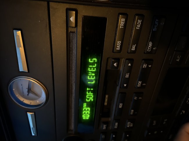

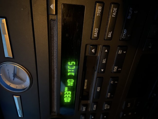

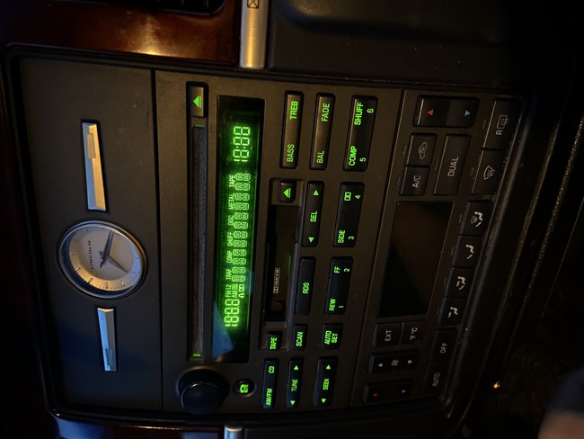

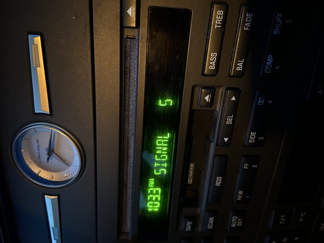

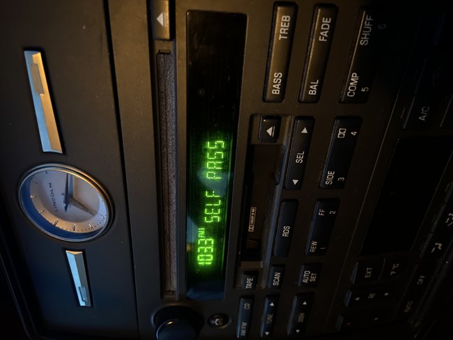

Okay, I went through all five of the tests. Now I got the results.
The results are in the pic below!
Thank you!

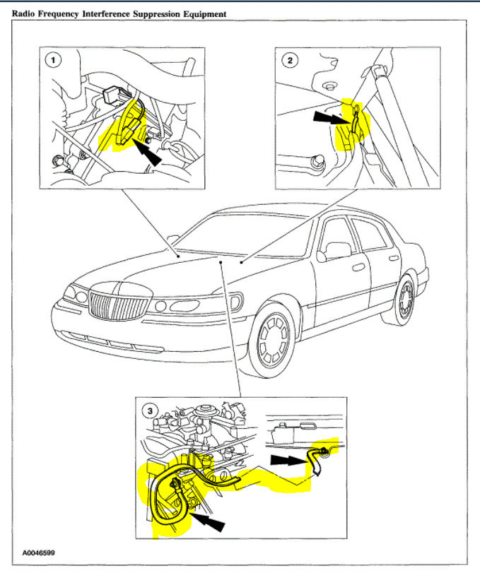

The radio isn't indicating any trouble codes. There are three things to check that are related to frequency interference suppression. If you open the hood of the vehicle, it is easy to check two of them.
If you look at the pic below, I highlighted two ground straps that I need you to confirm are connected, not damaged, and free of corrosion.
In the pic, there are three things shown. Number 1 is a capacitor. Numbers 2 and 3 are simple ground straps. Number 2 is located near the driver's side hood hinge. One side is bolted to the hood and the other to the cowl, number 3 in the pic is the same type of ground strap, but it goes from the cowl to the engine.
Make sure these aren't broken or nearly broken.
If these are good, there are no codes, and you only have interference in the FM mode, it sounds like the radio itself has internal problems.
See pic below.
