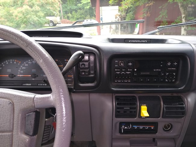

Radio is hung up in cassette mode nothing appears to be jammed inside will not accept cassette goes in about 3/4 of way clock runs but I cannot change it. when I push the eject it goes through the motion but then goes right back to play like there is still a cassette in it. AM/FM cassette radio with infinity.
Any ideas?

Will try and let you know what happens. Have added a photo of my dash. This is a mobility van that's what the yellow switch is for.

Sounds good is this a 95, looks newer?
May 7, 2019 at 7:21 AM
NJK4121
Yes it is a 1995. I have the radio out, there was nothing loose inside, should I be able to get a voltage reading on the connector when I put the key in either Acc. or run mode? I found the wiring diagrams you posted but when I put the meter on either the pink or red/white and ground. with the key in position I don't get a reading.
