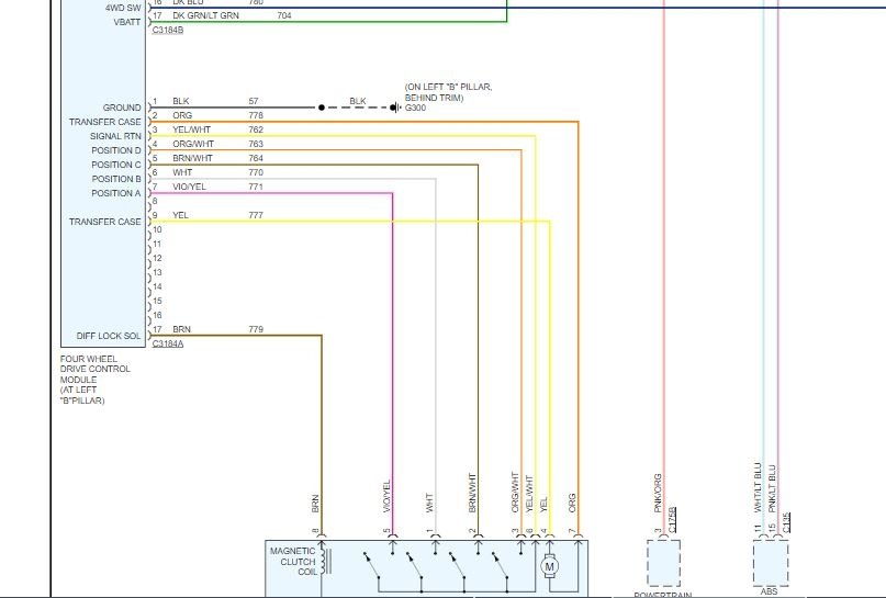

The yellow wire comes from the module in the truck. Diagram attached.

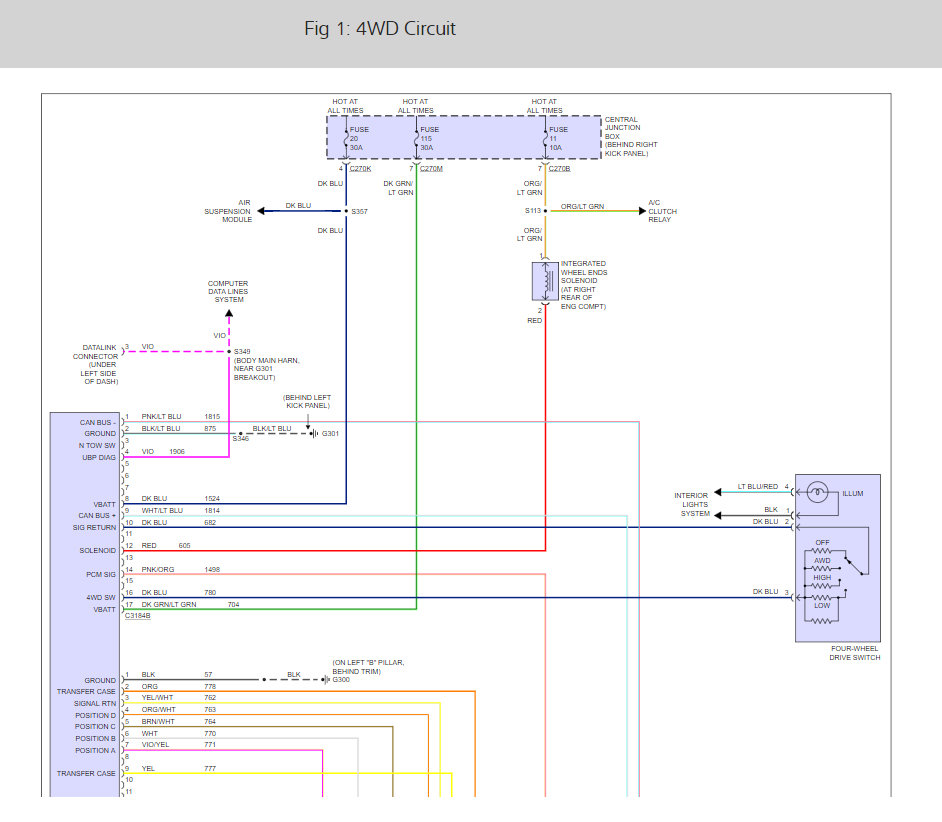

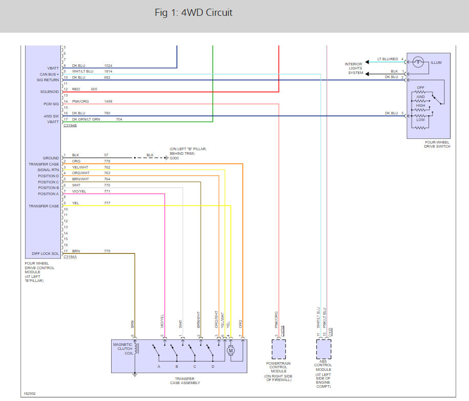

Here is the complete 4wd wiring diagrams with a guide to help you test the connection:

Sorry, I have to the splined gear on the front axle side gets pulled into a neutral position when the white wire to the magnetic clutch coil receives power. That's the prob Bob. Now I have to find out why it is not getting power. Is there a simple relay you know about that I can locate and change? I don't think it is the TCCM because I tried three others and they didn't help. Any ideas?
Mar 25, 2019 at 11:31 AM
I sent you the same diagram Ken sent you as well. There is no simple relay in the circuit.
Can you get a scan tool that can do bi-directional testing and see if you can command this thing into two wheel?
