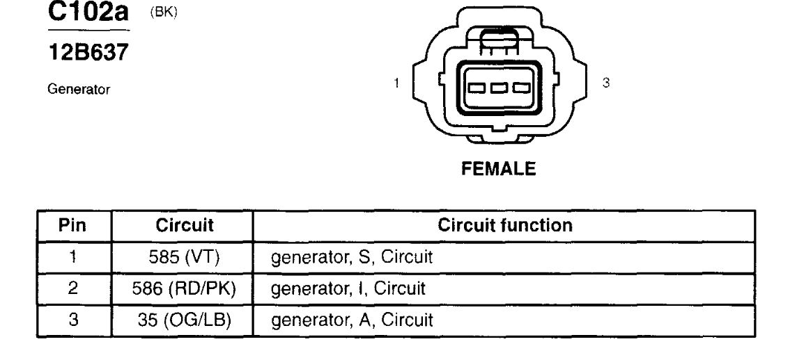

I am replacing the alternator on my van and when I tried to remove the electrical 3 wire connection to the alternator I pulled the wiring out of the Duralast Throttle Position Sensor Connector 611. Went to AutoZone to get the replacement connector, but I find myself unsure how to match the vehicle colored wires to the pigtail on the part.
The three colors available are red, orange and purple.
Anyone have the wiring diagram for this part?

Good afternoon,
I attached a picture of the connector with the correct wiring set ups.

Thank you Roy, that's what I was hoping for.
