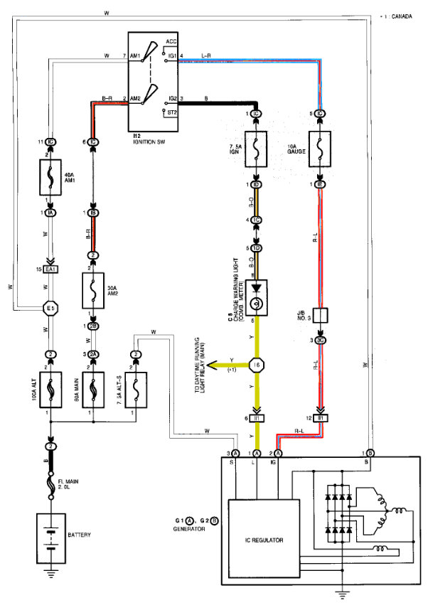

Alternator wiring diagram needed
1998 TOYOTA CELICA
240,000 MILES
JEGATRO
MEMBER
2 POSTS
Plug has perished and don't recall the order they went. Mine is an ST model 2.2 liter.
Oct 14, 2021 at 2:05 PM
SQM
Experienced Mechanic
6,383 POSTS
I have attached the wiring schematics for the charging system. It shows the wiring orientations for the alternator.

Thanks very much. And for being so quick. Muchly appreciated.
