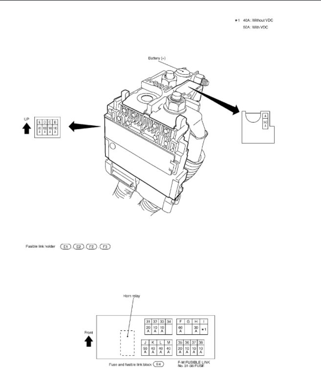

Was changing alternator without unhooking battery alternator wire sparked on metal car has no lights and will not start.
Jan 21, 2021 at 11:49 AM

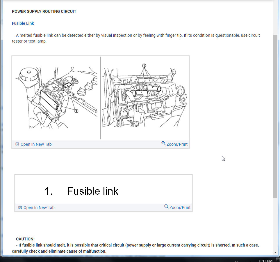

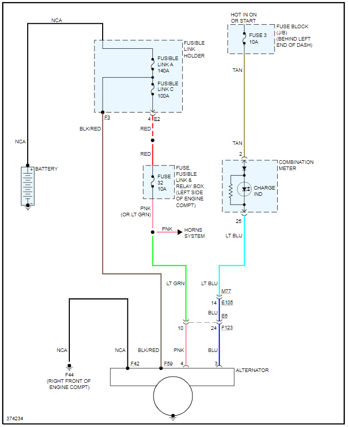

More than likely you blew a fuse. There is no guarantee which one but since you have no lights and it won't start I suspect it is one of the fusible links. Here is a guide that will help with this:
Also, below is the info on these links as you will see them on the wiring diagram.
Let us know what you find. Thanks
