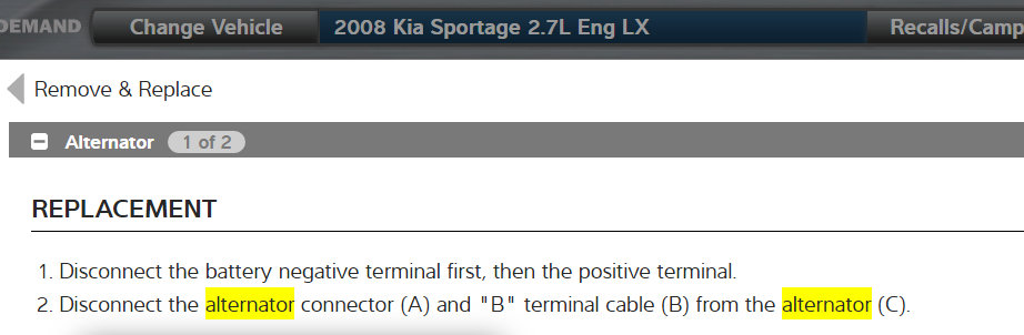

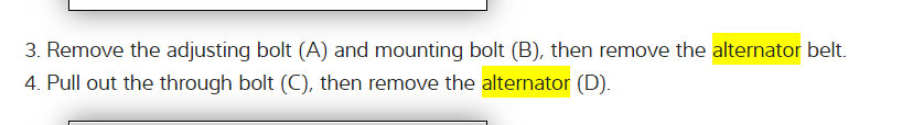

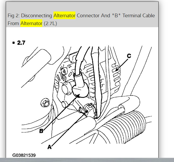

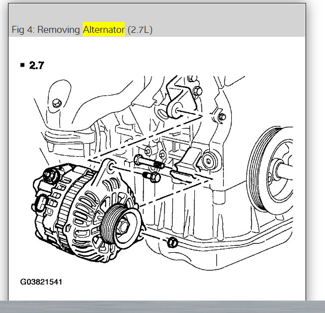

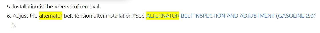

How do you get to it?
May 13, 2019 at 11:19 AM
SCGRANTURISMO
  • 4,897 POSTS
I have included in the diagrams down below the instructions for removing your vehicle's alternator. The installation is going to opposite of the removal. Please, let us know how everything turns out please.
