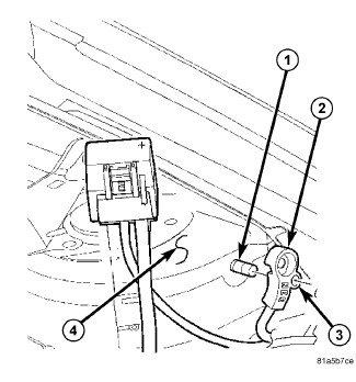

The negative battery cable remote terminal (2) must be disconnected and isolated from the remote battery post (1) prior to service of the vehicle electrical systems. The negative battery cable remote terminal can be isolated by using the supplied isolation hole (3) in the terminal casing.
Disconnect and isolate the negative battery cable (2) remote terminal from the remote battery post (1).

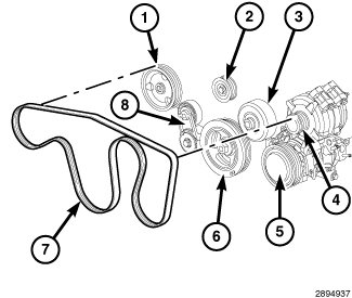

Rotate the belt tensioner (8) counterclockwise until it contacts the stop, remove the accessory drive belt (7) and then slowly rotate the tensioner into the freearm position.

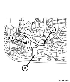

Remove the coolant supply line (2) at the heater supply line and position aside.
Remove the upper radiator hose (3) at the radiator and position aside.
Remove the wiring harness retainer (1) from the upper frame rail and position aside

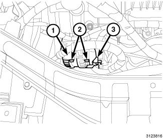

Unsnap the plastic insulator cover from the B+ terminal.
Remove the B+ terminal retaining nut and remove the B+ terminal.
Depress the field wire electrical connector tab and remove the electrical connector (3) from the generator (1).
Remove the two upper mounting bolts (2) from generator (1).
Remove the lower mounting bolt from generator (1).
Remove generator (1) from engine mounting bracket.

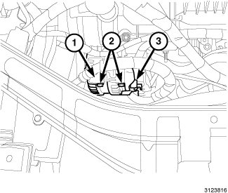

Position the generator (1) onto the engine mounting bracket.
Install the lower mounting bolt and the two upper mounting bolts (3) to generator (1). Tighten bolts to 42 Nm (31 ft. lbs.).
Connect the field wire connector (3) to the generator.
Install B+ terminal and nut to generator mounting stud. Tighten nut to 10 Nm (88.5 in. lbs.).
