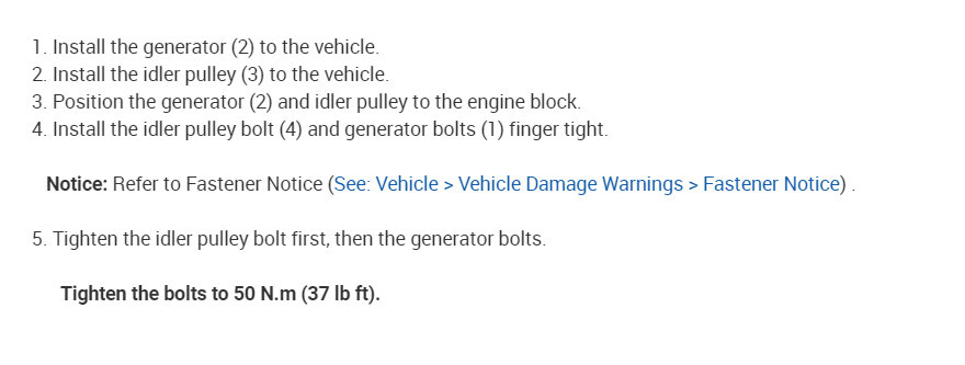

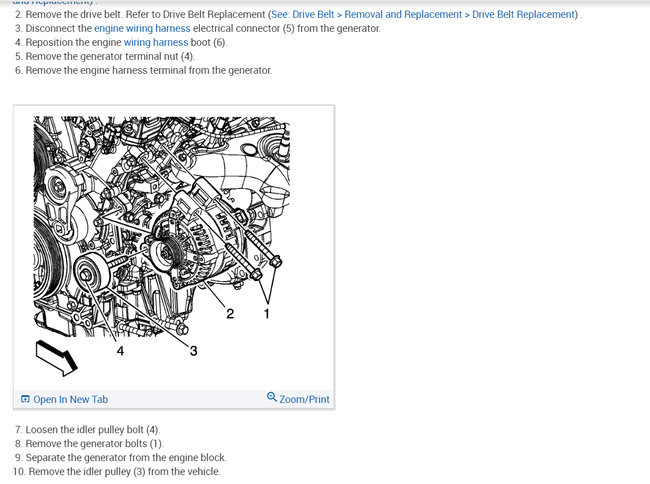

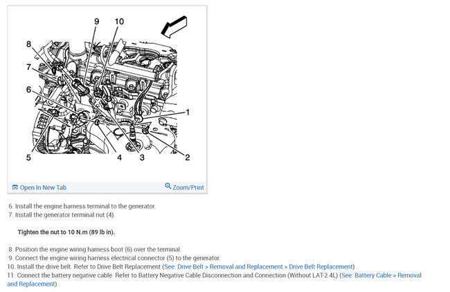

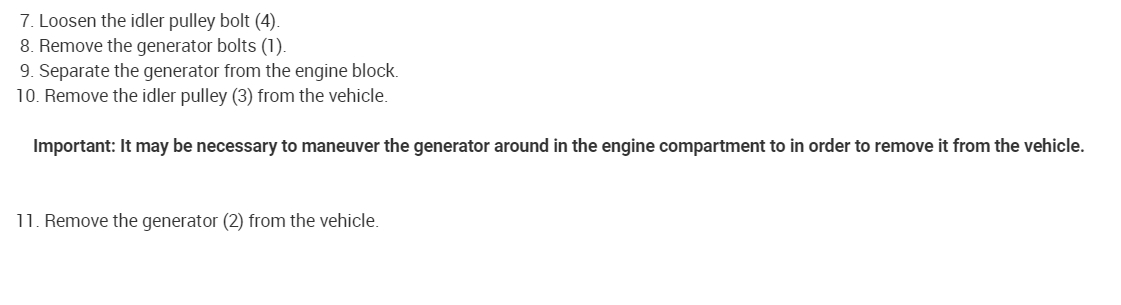

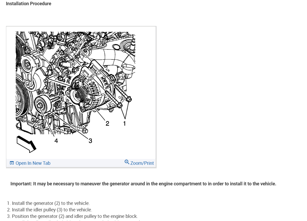

How do I replace the alternator in my son's car listed above?
Aug 22, 2022 at 5:38 AM
  • 55,732 POSTS
I assume you have the 2.6-liter engine; I have included the alternator replacement instructions in the images below. Starter by disconnecting the battery (negative side). Also, here is a generic guide to help you see what you are getting yourself into when doing the job:
https://www.2carpros.com/articles/how-to-replace-an-alternator
