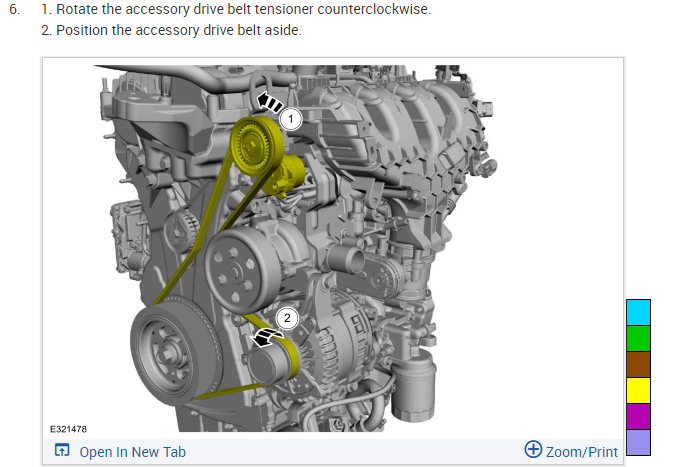

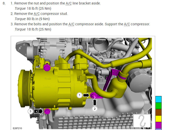

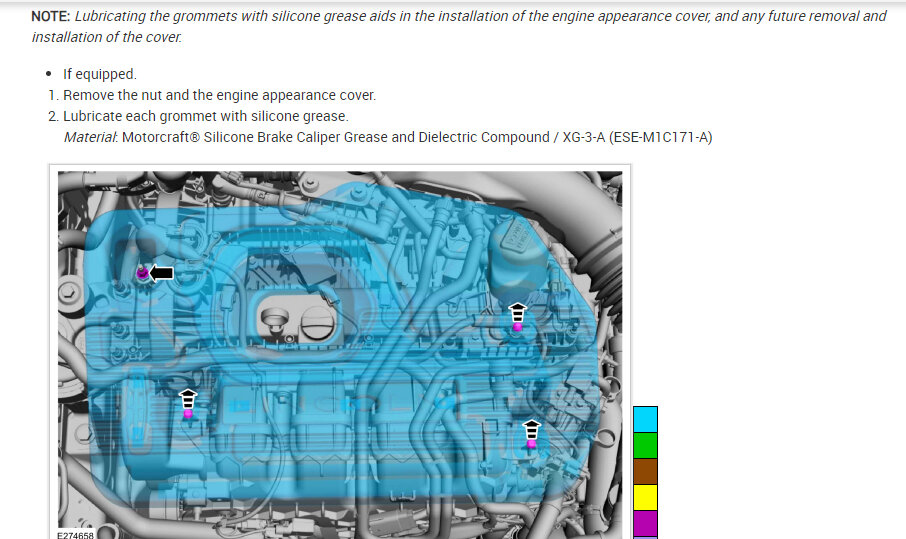

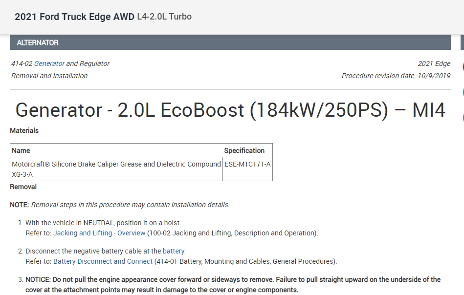

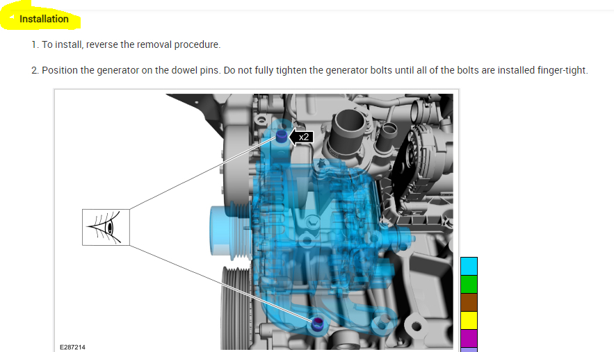

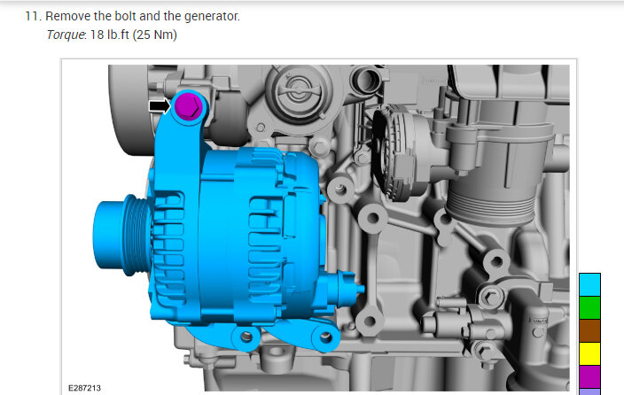

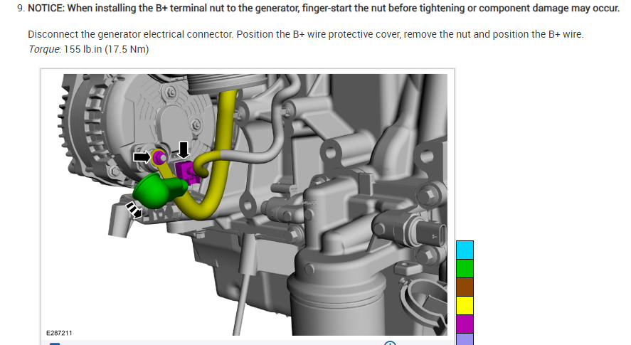

How do I replace the alternator on the vehicle listed above? I was told it needs to be replaced and is out of warranty.
Thank you!
Jun 1, 2024 at 10:23 AM
  • 110,248 POSTS

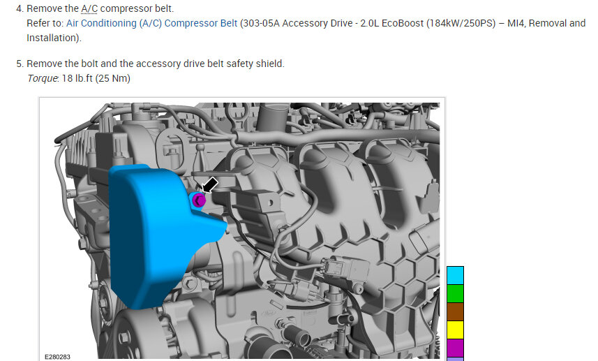

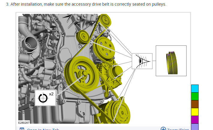

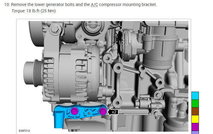

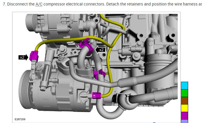

To replace the alternator, you will need to work from under the vehicle. Also, before you start this job, make sure the battery negative terminal is disconnected.
Here is a link that explains in general how it is done:
https://www.2carpros.com/articles/how-to-replace-an-alternator
If you look below, I attached the directions specific to this vehicle. Take a look through them and let me know if you have questions.
Take care and let me know how things work out for you.
