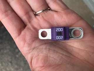

Started having issues yesterday getting the car to start. Dash displayed Battery Saver On and all interior lights etc., seemed to be working fine. Got a jump from my in-laws and got home fine. Husband tried starting car this morning and it was completely dead with no dash lights etc. Jumped it, however as soon as the cables were removed the engine shut off on its own. Replaced with a new battery this morning, sat for a few hours in the driveway and car wouldn’t start. Went back an hour or so later and it started with the dash message Service Charging System.
Thinking the alternator needs replaced, but if anyone else has any ideas I’m all for it. Husband typically does the work on our cars, but I really struggled to find any info on this.

It does sound like the alternator isn't charging. Also, if it failed, it could be placing a constant draw on the battery.

My husband found that the 200 amp fuse that was connected to the wire of the battery post to the alternator is bad. Hopefully a much easier and less expensive fix. He went to multiple dealers yesterday afternoon and none of them could figure out which part to order based on entering the VIN. They printed off a list with part numbers, but when I search the GM part numbers online they all use a generic picture so I have no clue which is correct. This can't be that hard, right?! It's a 200amp/58V SBFW-L M6 bolt type fuse.

That is the correct part number. That is a bolt in fuse. Please keep an eye on things. It takes a lot to blow a 200 amp fuse. Tell your husband to check all the main wiring to and from the alternator.
Let me know if there is anything I can do to help.
