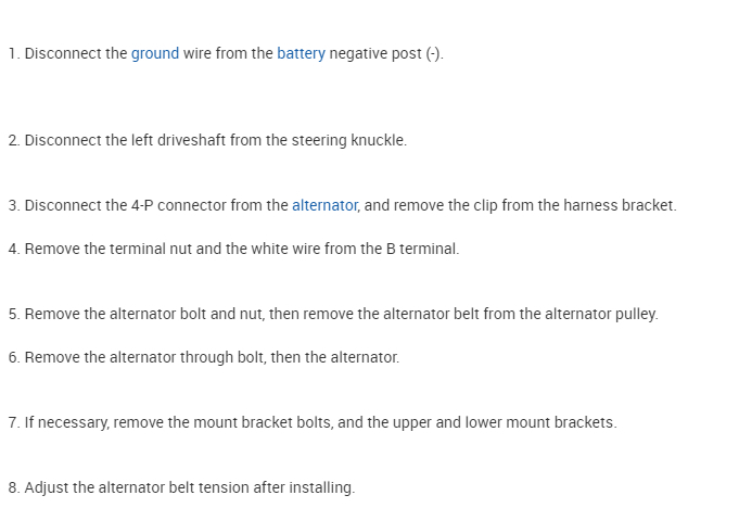

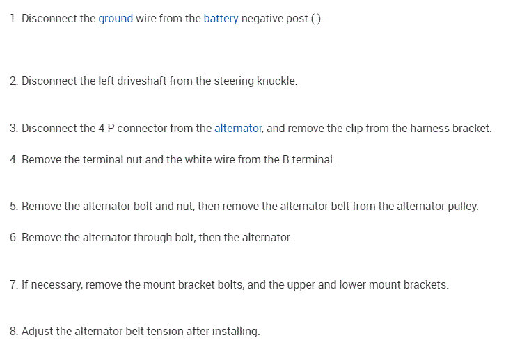

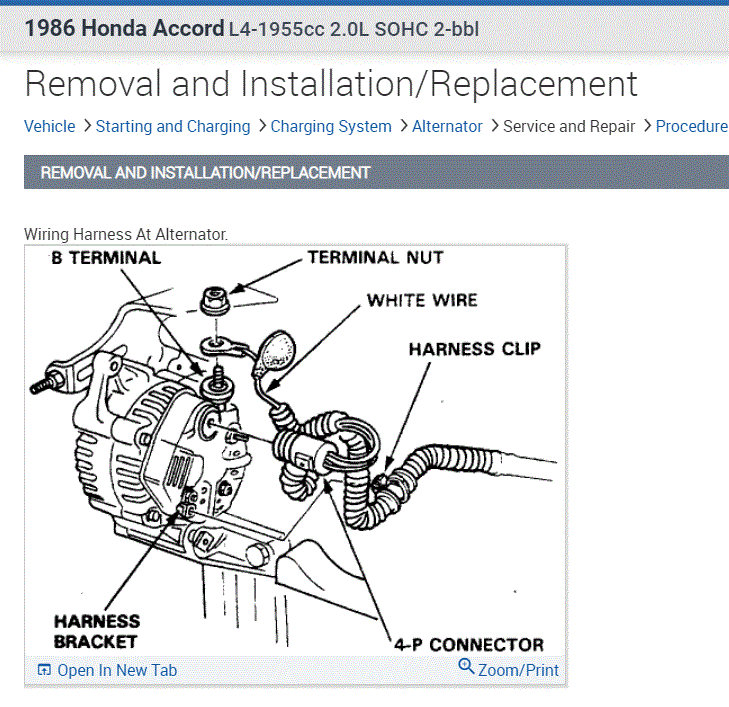

Don't exactly know where the alternator is on the car listed above LX this is something different.

I have attached the replacement procedure for the alternator below.

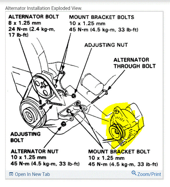

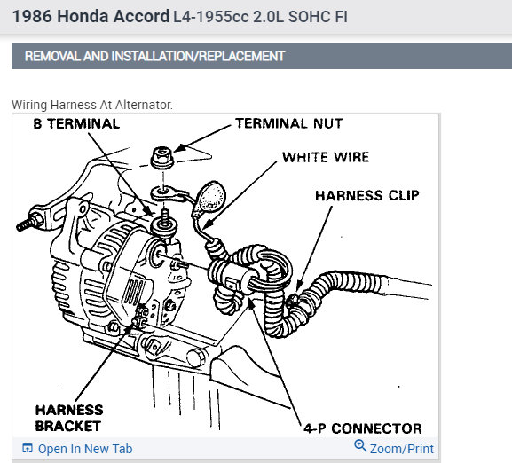

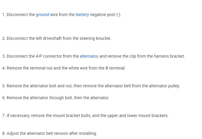

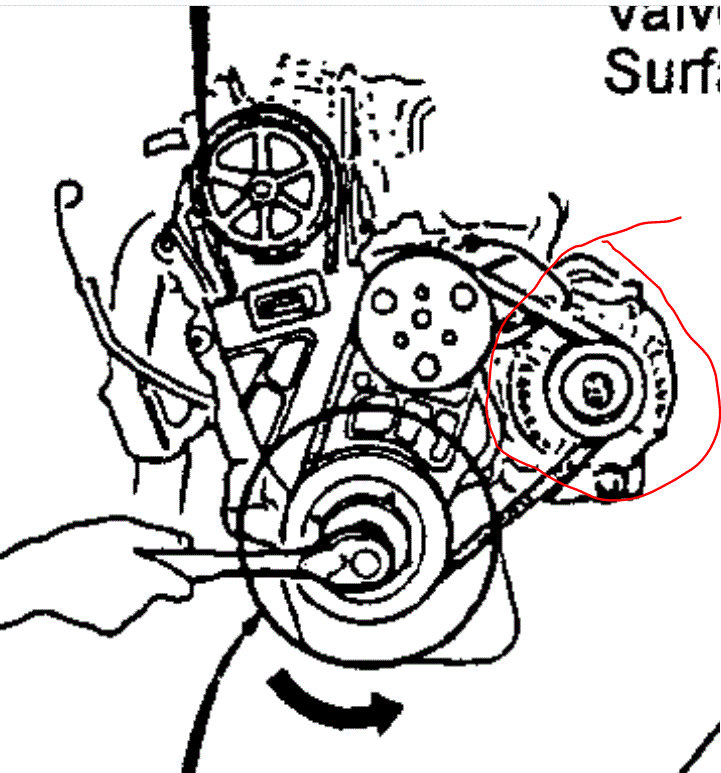

As far as the alternator is concerned, it is located toward the bottom front of the engine. See pic 4
Pics one through three are the directions for the removal and replacement of the alternator. Make sure before you start the procedure to disconnect the battery.

What do I got to move out the way to get to the alternator?

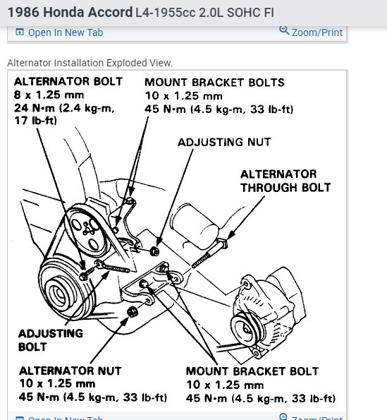

Dale,
You should be able to access it from under the vehicle. If there is a plastic splash shield, remove that and see if you then have access.
If that doesn't help, take a few pics and upload them for me to see. Hopefully, I will be able to direct you. However, if I remember correctly, it comes out through the bottom.
