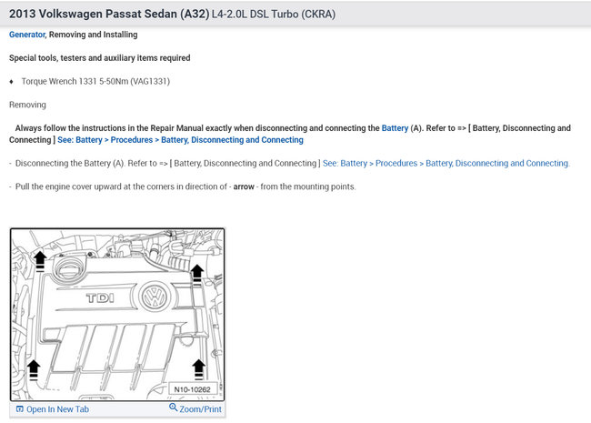

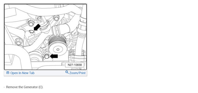

I'm trying to change out he alternator Not sure if it changes out from the top or bottom. I'm trying not to open up the A/C system. Any help would be appreciated.
Aug 20, 2022 at 4:33 PM
  • 55,743 POSTS

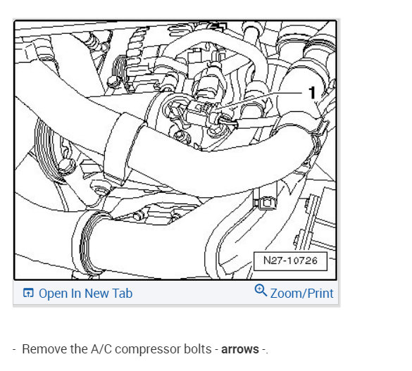

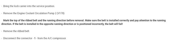

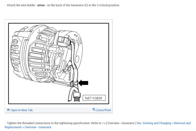

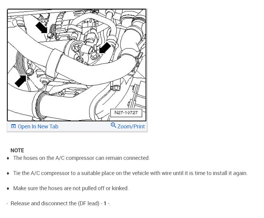

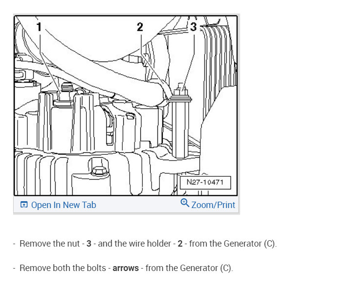

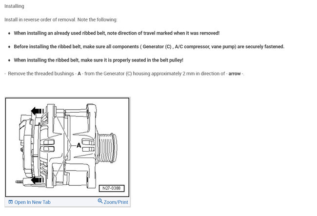

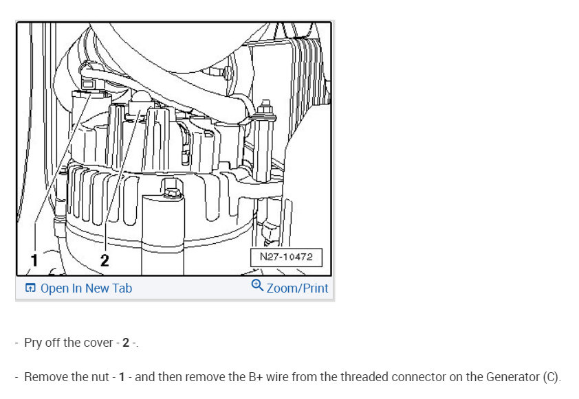

I found the instructions on how to replace the alternator and it does say you need to remove the A/C compressor mounting bolts, but you can leave the lines connected. Make sure the battery is disconnected. Check out the images below to see how the job is done. Please let us know if you need anything else to get the problem fixed.
Aug 21, 2022 at 4:46 AM
SOREKNEES60
You didn’t answer my question.
Sep 19, 2022 at 12:48 PM
  • 55,743 POSTS
Sorry, you remove the alternator from the bottom.
