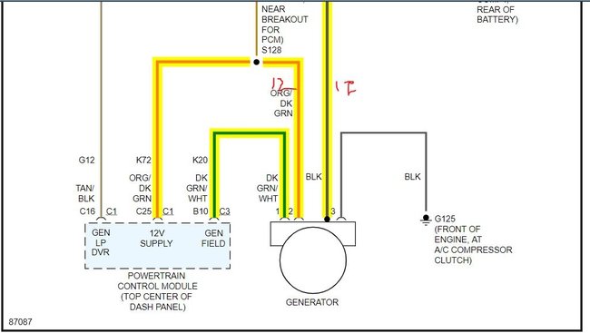

Had to change the alternator wiring harness connector on the back. Rewired it. Voltage reads 4 on one small terminal and 10 on the other small terminal. Voltage reads overload on b+ terminal. All of this reading while engine is running. Did i wire it wrong? Is the b+ terminal not regulating the charge? It’s not charging the battery at all and the gen light is on in dashboard.

Good afternoon,
Overload? It should read around 14 to 14.5 volts. Can you verify that?
That red wire is a feed from the battery for the magnets inside the alternator.
I attached a diagram for you to view. The one wire should have battery voltage. the red one needs battery voltage as well. The other wire comes from the ECM to regulate the charging.
Jun 18, 2020 at 2:59 AM

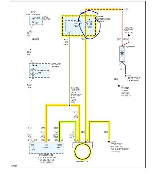

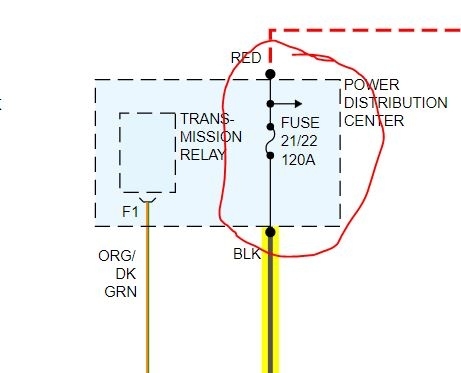

The voltage isn’t going up from 12.2 volts when i turn it on so the alternator is not charging the battery. How do i check if the alternator is getting enough power from the connector to work? What should the voltage from the gen field terminals and b+ wire read and how should i interpret that? Where is the alternator fuse?

The black wire should have battery voltage.
The red wire should have battery voltage.
The dark green gets a pulsed voltage from the ECM for charging. Your meter will not pick it up.
The fuse is in the power distribution center and the number is marked on the diagram.

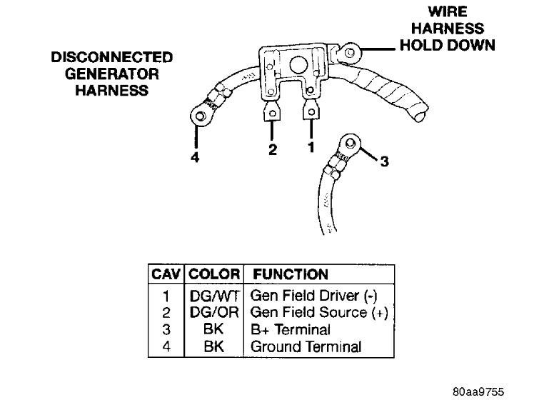

The new connector that i connected has 2 green wires instead of a red and green wire. Does that matter?

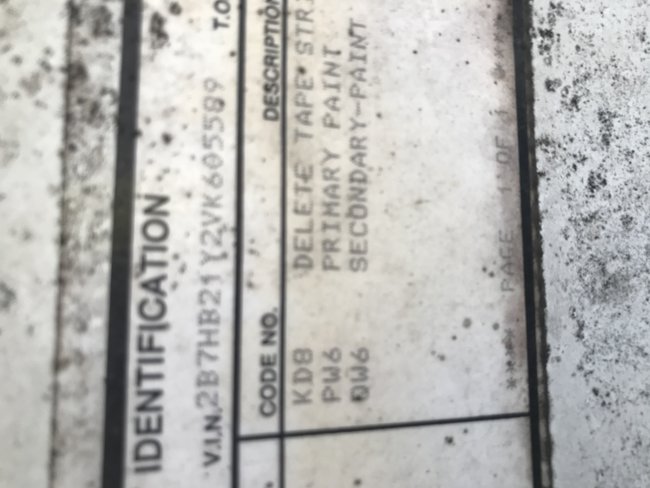

Can I have the complete VIN number from the van?
Jun 18, 2020 at 3:29 AM
JAFAR1771
  • 9 POSTS
2B7HB21Y2vk605589

Okay, you should have 2 wires that have battery voltage, The other is the field from the ECM. You need a scan tool to turn it on.
Check again to be sure.
