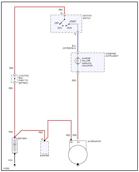

Power steering pump was going out still working but not like it should. Don't know if it affected my charging system causing a drag. My alternator went out and last Thursday I replaced my alternator and still my warning lights coming on letting me know charging system is not working like it should. I drove it to the auto parts store and had the alternator retested where it was in specs, but low end ( I thought alternator always need to be 14.5 when tested, it was at 13.32 that night). I just replaced power steering pump today and when I ordered it yesterday, I had the alternator tested again and it was 11.22 the guy said that it's voltage regulator is bad. So after putting on new pump today, I tested alternator and battery again and it is starting charging up battery and testing back of alternator, numbers started climbing up but still in the 12-13 range not 14.5. I going to replace the alternator once again tomorrow but wondering what else could be causing a drain. I cleaned the grounds, replaced connectors but with Volvo's just wondering if I am missing something else. I'm hoping that I just got a bum re-manufactured alternator (it happens) but anyone else has any suggestions for this DIY lady I would appreciate at it. Thanks my ride is 1988 Volvo 244GL automatic no turbo.

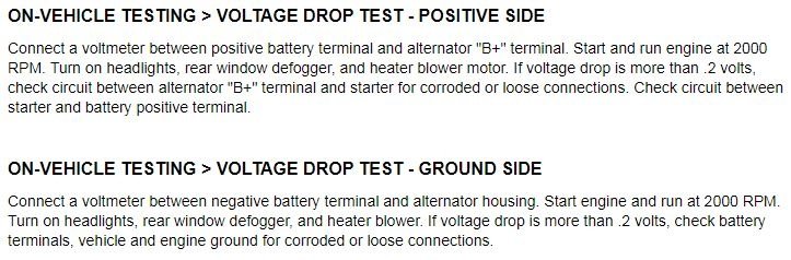

If the belt checks out okay, there's two more quick tests that need to be done before condemning the alternator. You'll need to perform a voltage drop test across the positive battery cable between the battery positive post and the B+ terminal on the alternator. You'll also need to measure voltage drop between the battery negative terminal and the alternator housing. See attachment for the detailed procedure. I've also included a wiring diagram of the charging system.
