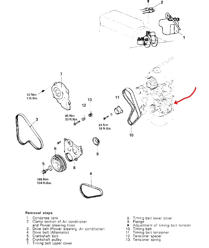

something is missing after engine repair and alternator does not seem to fit correctly.

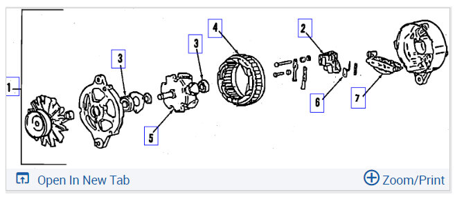

You could have the wrong alternator, here is what it is supposed to look like, here is the part number it is supposed to have
Alternator Assembly - MD189659 $707.00
Can you send images of the problem so we can help walk you through it? Check out the images (below). Please let us know what happens.
