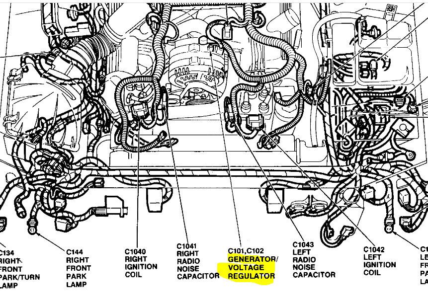

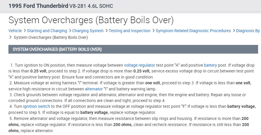

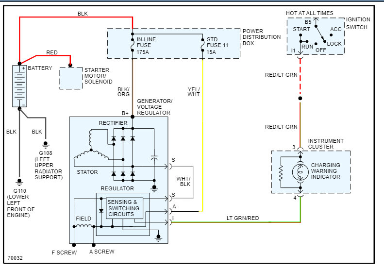

I attached the schematic and a few other pics below so that you have a reference.
See pics below. Note: Pic 1 is the diagnostics for an overcharging alternator. Basically, an auto parts store does this when they test it.

Is there any chance of the harness being the issue, this is not a road use vehicle, and a few sections of harness were chewed through by mice. I’m not 100% sure if any of it was to the regulator but it’s a possibility.

I have a feeling that if there is wiring damage, it led to the regulator failing. So, yes, the harness is a big issue and concern.
Carter, keep in mind that these types of issues can lead to a fire. Here is what I suggest. Inspect the wiring harness damage. Anywhere there is damage needs to be repaired and insulated.
Next, remove the alternator and have it bench tested. If the regulator has failed, the alternator needs to be replaced.

Would you be able to get me all the ground locations mentioned in the troubleshooting guide from pro demand?
Apr 6, 2023 at 7:26 AM
  • 110,244 POSTS
As far as the grounds are concerned, there is really only one you need to worry about. Between the battery negative terminal and the left front of the engine. If you follow the negative battery cable, it will lead you to where it is bolted to the engine. The alternator is grounded through its mount via the engine ground. There is one other. It's a smaller gauge ground from the battery negative and is attached to the radiator support on the driver's side.
