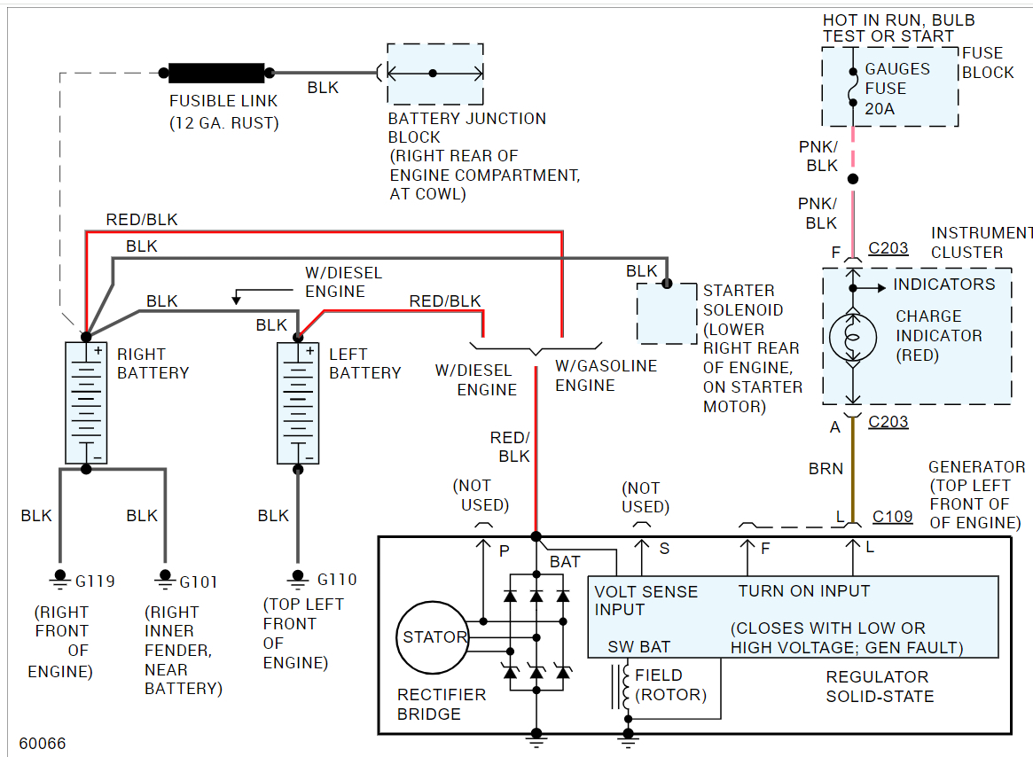

Yesterday i installed a new alternator and today now i drove it and the alternator stopped working I'm thinking it's a wiring issue now.
Sep 9, 2024 at 11:44 PM
  • 55,711 POSTS
Chances are the alternator is defective, which is common, but here are the wiring diagrams and a guide to help you test the connections to ensure the system is working correctly.
