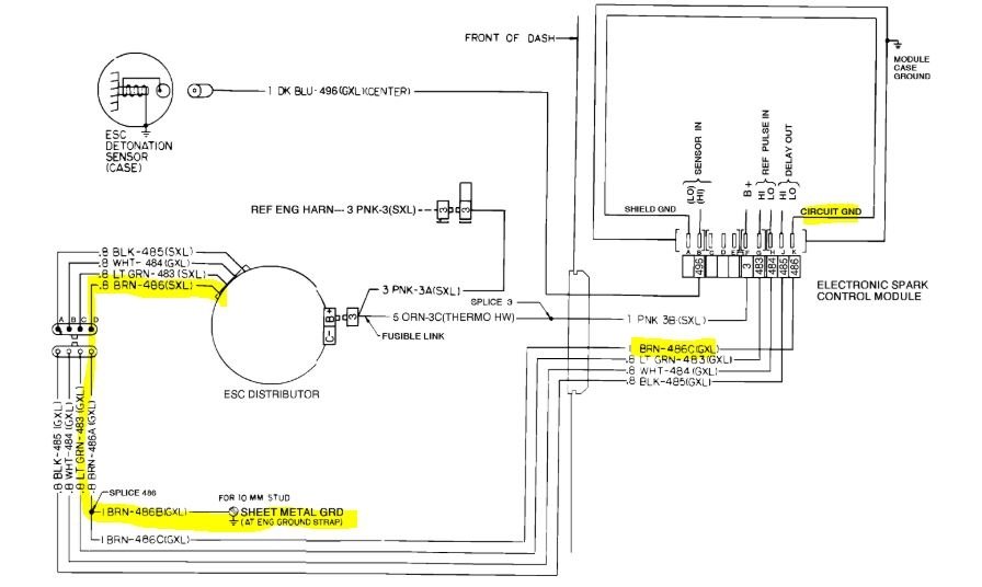

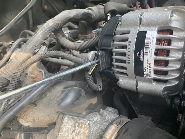

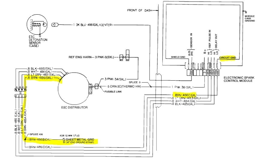

Hello, I was driving my truck and that amp gauge dropped to 12 volts. Dlc displays battery not charging I tested alternator with volt meter it is only showing what the battery is holding in charge. I replaced the alternator and I had the same issues again so I went out and bought another alternator and it is still doing the same thing. So I decided to get a test light and hook it up to the positive on the battery and I probed the brown wire on the three prong plug on the back of the alternator. And the alternator immediately starts charging and the dlc message goes away and the volt meter in car jumps to 14 volts. As soon as I remove the test light with the 12 volts the alternator stops charging. I have no wire diagrams. I did cut the brown wire thinking there was a break in it but it still did not work.

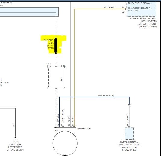

I think we have a power issue. When you put power to the brown wire, it is turning off the battery light, but I doubt it is charging the battery. What I need you to check first is the if there if there is power to the B+ wire on the alternator. That should have battery voltage all the time. If it doesn't, suspect a bad fusible link. Take a look at picture 1.

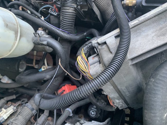

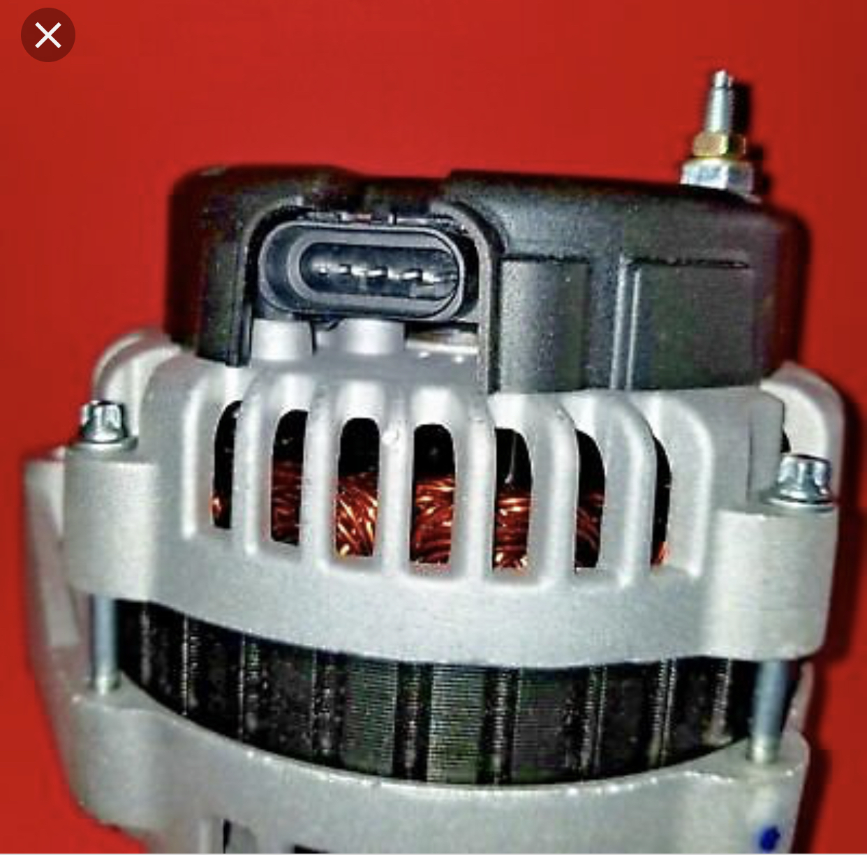

Picture 2 shows that the brown wire you are referring to. If you are going from the battery + that will turn off the battery light.
Let me know what you find.

Thank you. I will look this weekend and let you know I appreciate your reply. Thanks for the schematics.

Yes, the voltage at the back of the alternator is the same voltage that the battery has. The alternator has the plug with 3 wires on the back along with a black wire with a connection that goes to the red battery box.

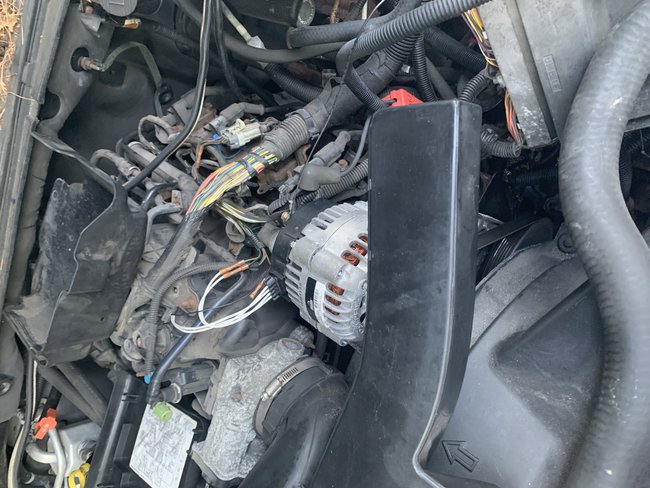

I got it going. I just got to wrap everything up. I cut the number 15 wire close to the ECM ran a new wire from there to the alternator brown and now it’s charging no dlc or battery light. Thank you for your input.
