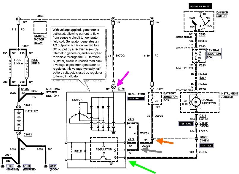

Driving one day I started losing power, battery light started flashing, gages all dropped (shut it off, probably not the best idea, wouldn't turn back on.) My friend hooked up another battery to get me the couple miles home.
Took the alternator off, had it tested 4x, all 4x it came back good. Checked all fuses (including 175a fuses), replaced serpentine belt, replaced tensioner pulley and (+) battery cable and alternator plug. Vehicle starts but battery still isn't charging.
Just to give as much detail as I can:
After changing serpentine belt (first thing replaced), started it up, OBD2 reader read "Normal" 14.1v, turned on the lights, high beams, radio hazards etc., sat there for about 20 minutes and let it idle, everything was running/reading fine, put it in reverse, backed up, OBD2 reader goes back to "abnormal", voltage dropped back to 11.9v and hasn't gone back to normal since then.
We are stumped at this point. My boyfriend did mention the exciter wire is only showing 2.3v. This was just discovered last night. We've spent hours reading forums, watching videos, asking friends.

Bench-testing generators is not the best way to diagnose this system. it's even less effective for starter motors. To add to the misery, you're describing an intermittent problem. Any testing has to be done while the problem is occurring. You don't know when that is during a bench test.
I have a suspicion there's worn brushes inside the generator, but to start the diagnosis, watch the red "Battery" warning light on the dash. That circuit provides the "wake-up", or "turn-on" signal to the voltage regulator. If that bulb lights up when you turn on the ignition switch, that circuit is okay. That ends in the light green / red wire in the three-wire plug at the side / back of the generator, (green arrow). Most of the 12 volts is used up across that bulb. What's left is the voltage you'll measure on that wire. If that's the wire you found 2.3 volts on, that's perfect. Once the engine is running and the charging system is working, the regulator will put full system voltage back out on that light green / red wire to turn the warning light off.

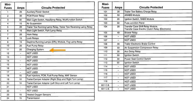

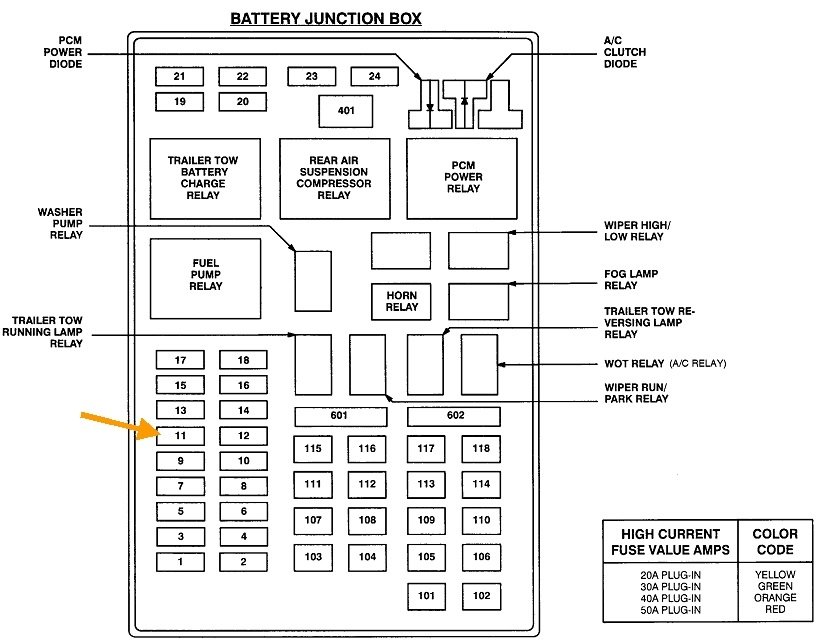

The orange / light blue wire, (orange arrow), provides the current to run the voltage regulator and the field current for the generator. You must find full battery voltage on that wire all the time. If it's missing, check the 20-amp fuse in the under-hood fuse box.
Also check for full battery voltage on the fat output wire bolted to the back of the generator. If that is missing, the fuse link wire is burned open. You'll have plenty of other symptoms besides a no-charge condition. That fuse wire burns open due to two or more shorted diodes in the old generator, or the output terminal was accidentally grounded when hit by a wrench when working in that area.

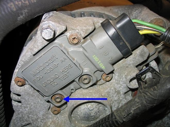

In addition to these tests, there's a test terminal on the back of the generator's housing, as shown in the second photo. By using a piece of wire to ground the screw the blue arrow is pointing to, that bypasses the voltage regulator. You can use a digital voltmeter across the battery terminals to watch what happens when you ground that screw, but it's just as easy to watch the brightness of the head lights or listen to the whine as the generator loads down the engine. I forgot to mention the engine must be running for this test. If system voltage goes up when the test screw is grounded, that proves the voltage regulator is defective. Those can be replaced separately by unbolting the screws in the four corners. New brushes come with the new regulator. You'll see the new brushes are held retracted with a tooth pick. That must be pulled out and discarded only after the regulator is bolted in place. You'll hear the two light clicks as the brushes pop into place as that tooth pick is removed.
If system voltage doesn't increase when the test terminal is grounded, it suggests the regulator is most likely okay and something else is causing the problem. The three previous voltage tests should identify that. To be valid, those voltage readings must be taken with the connector plugged in. Back-probe through the rubber seals alongside each wire to take those readings.
I haven't mentioned the white / black wire yet, (gray arrow). When the generator develops its proper output voltage of 13.75 to 14.75 volts, exactly half of that will appear on this white / black wire. It goes into the voltage regulator to tell it the system is working. That is what the regulator looks at to determine when to put system voltage back out on the light green / red wire to turn the warning light off. We typically don't bother to look at that white / black wire as part of any diagnosis.
Besides the no-charge condition, this voltage regulator is also capable of detecting an over-charge and an under-charge condition, and will turn on the warning light for those issues too.
