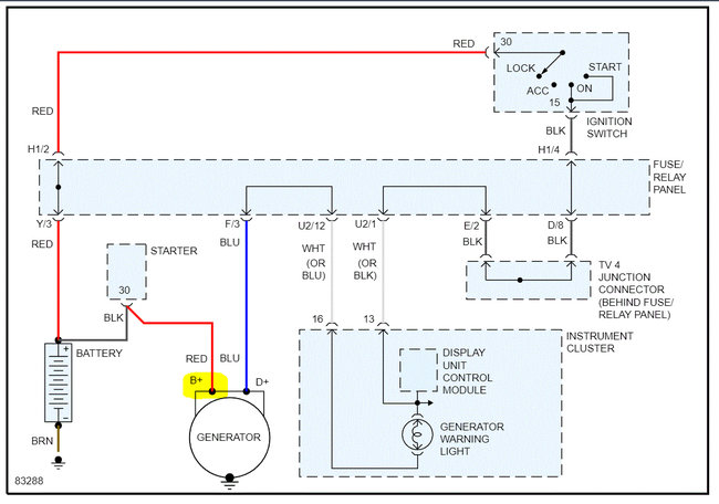

Changed alternator and battery charge light still on.
Jun 2, 2022 at 2:17 PM
  • 110,194 POSTS
First, I need you to confirm the alternator isn't charging. All you will need is a voltmeter or a multimeter. Do this so we can eliminate any issues with the instrument cluster display module. Follow the directions in this link and let me know the results:
If the alternator proves not to be charging, I next need you to locate the red wire on the alternator connector. That wire should have 12v at all times. Check that to confirm.
I attached the charging system wiring schematic below, so you have a reference. Also, here is a link you may find helpful:
Let me know what you find.
See pic below.
