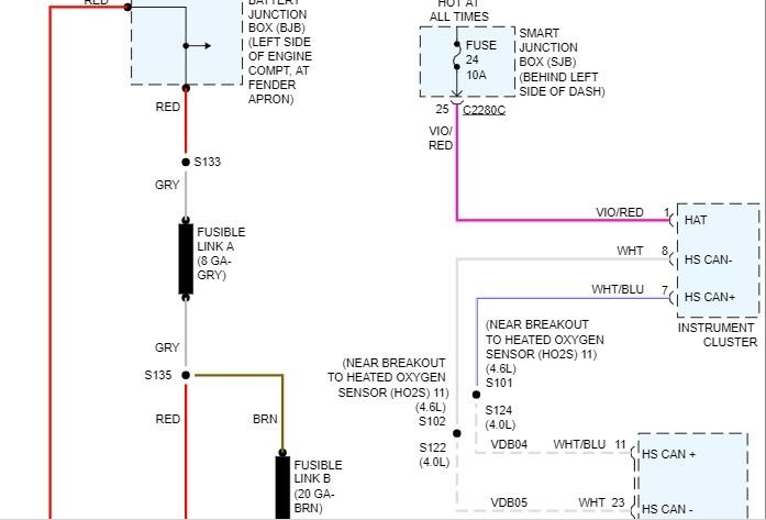

I have replaced the alternator and battery (both new), but found the alternator is still not charging the battery. Looking for advice on where to check next (possible fuses, fusible lines, grounding issues, etc. ). Or if there are any particular issues with that year/model. Electrical components on vehicles are not my strong suit.

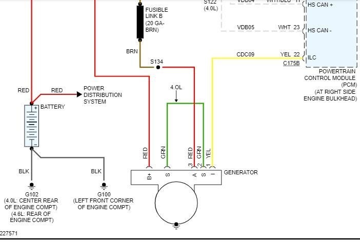

Chances are one of the two fusible links is bad. One is between the battery junction box and the alternator. The other comes off the alternator and back to the junction box. I have attached a schematic for you to see. I had to cut the picture in half to get everything copied. Thus, the second picture is a continuation of the first.
Check these links to see if one has blown.
