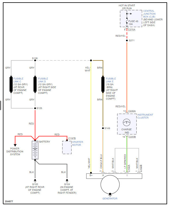

Runs the batteries down while running. With key off the orange wire on the three prong plug on the alternator is hot. With the key on the green wire is not hot but the orange wire is.

Please check fuse 45 in the fuse box on the left side of the dash. I'll post a link to the owners manual below that will have fuse locations in it. Check out the diagrams (Below). Please let us know what you find.

I liked the help, but the 45 fuse was good. Found the problem to be a service plug on the passenger side fender by the battery has the alternator looped in the connector and bad connection. Fixed and thanks for everyone trying to figure this out.

WESX
Figured it out by accident as I was cleaning the passenger side battery I looked down and on the fender by the bat was a connector with a green wire loop same color as the alt wire connector. Pulled it apart and cleaned up the pins plugged it back in and presto charging perfectly. This must be a service plug because it dead ends .
