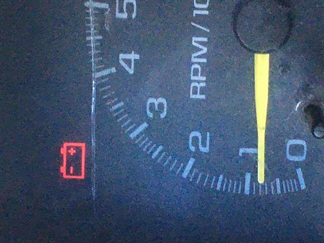

C2500 truck not charging. Truck will run for and drive for a bit and the voltage meter in the truck stays at 12.5 volts for 20 minutes.
Then slowly to 11 volts and then 9 volts and then the vehicle stops running.
Charge battery again and then starts and runs and repeats same thing.
Voltmeter test reading when truck running is same as battery voltage and not going up at all to 13 or 14v as it should.
The battery light in truck dash stays on permanently. The alternator lug on top has same reading as battery voltage, assuming the fuse able link is good then. As there is no difference in voltage. Would this conclude it’s a bad alternator/ voltage regulator? Could there be a peristatic draw in alternator?

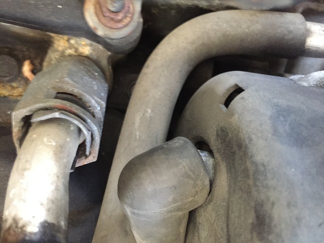

If you have battery voltage to it, it should be working. You are checking the power to the red wire where it attaches to the alternator, correct?

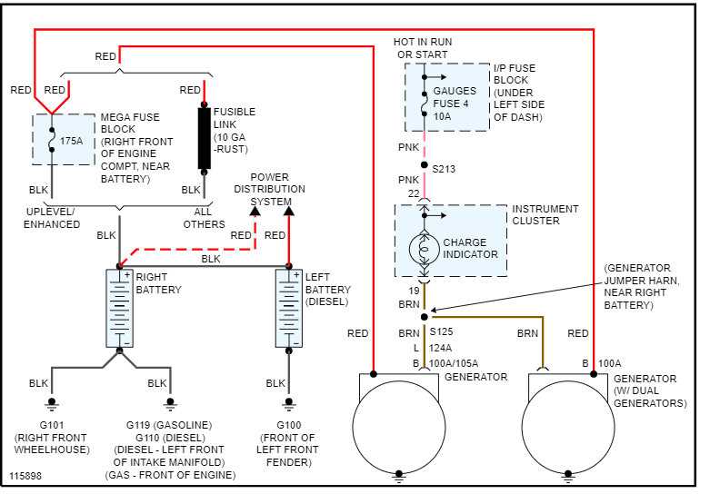

Also, as a reference for you, I attached the wiring schematic below specific to your vehicle.

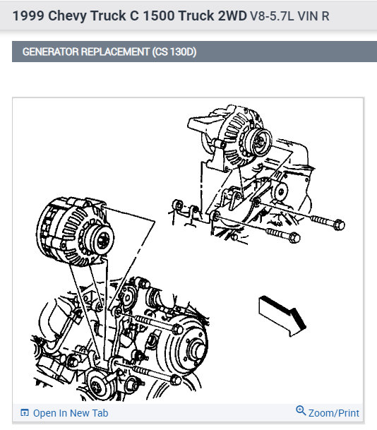

I attached the directions below for the removal and replacement specific to your vehicle.

Yes, the power wire with the protective boot at the back top of the alternator was checked. Picture provided showing the wire. This had the same voltage as the battery itself. I will remove it and take it to get it bench tested. I read that on certain vehicles if the battery is below a certain voltage, the regulator inside the alternator won’t trigger the alternator to produce any charge, is this correct?

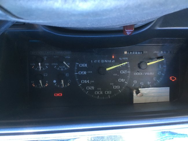

I saw in the pictures you sent, the smaller wire from alternator goes to the light indicator etc. I read somewhere if this indicator lamp doesn’t light up when first turning on the ignition switch this will cause alternator not to work? Or is this vehicle specific? The only things that light up as seen in pictures. Last owner of vehicle taped up the battery on light as you can see, probably to stop the glare when driving at night?

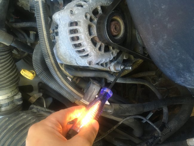

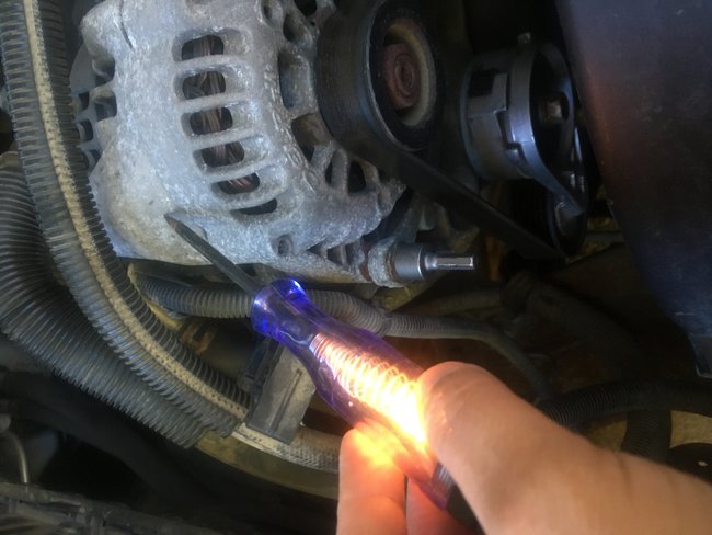

My wife put a light tester on battery positive post and touched bare metal on alternator in two places to show that the body ground is good to further rule out no ground issue to alternator.

The battery would need to be nearly dead. What voltage reading are you getting when you test it?

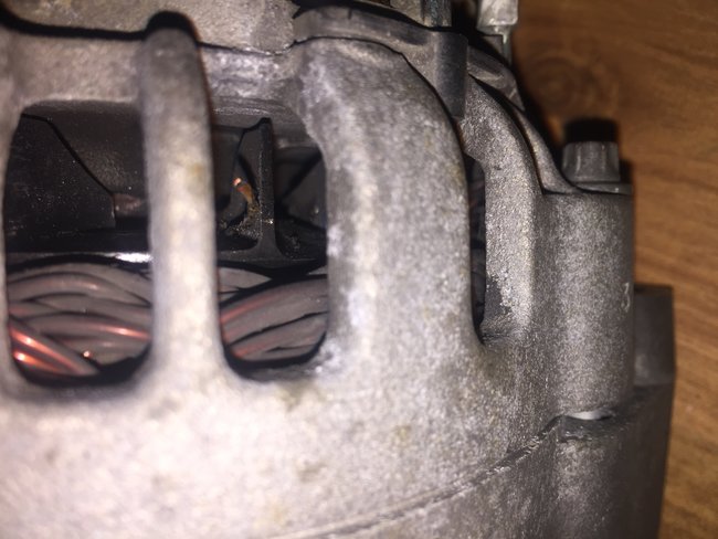

Joe, we had the alternator removed and sent in for testing at a electrical shop to find out it is defective and needs repair work as they found a broken ring soldered terminal in the stator? He said brushes are worn down to. You called it with a bad alternator from start, thank you. See image showing broken wire.
