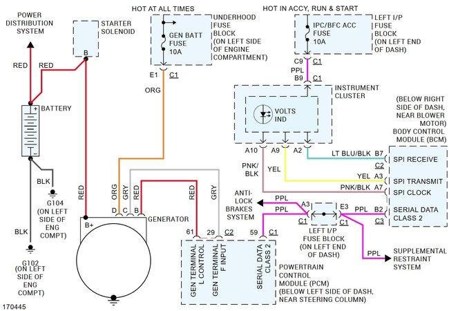

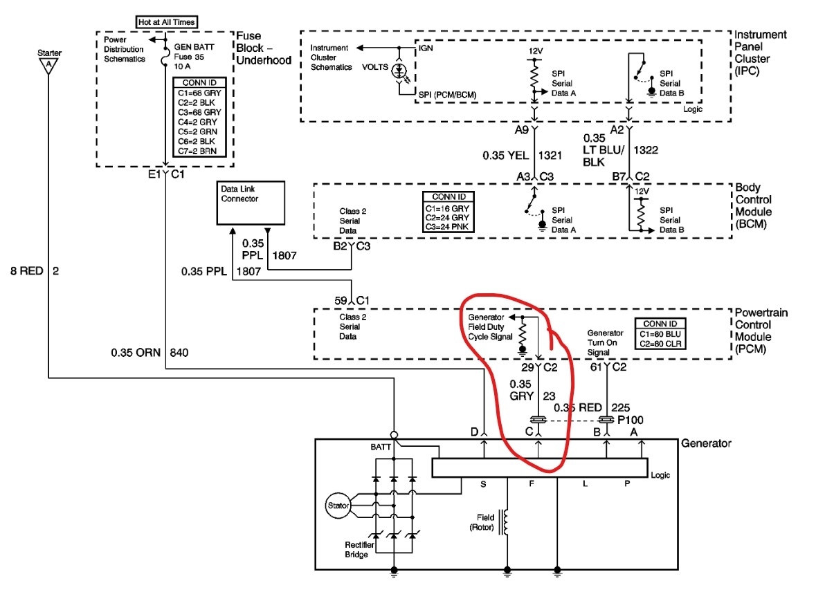

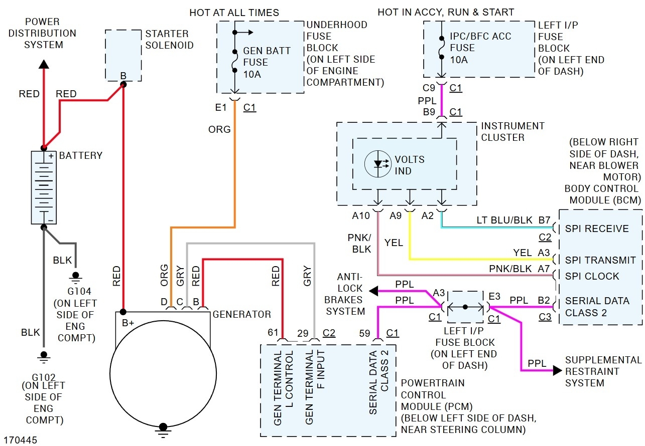

There should be a large red cable that connects to the battery stud. Then orange, gray and red wires that go into the connector for the alternator. The D wire is a feed to the alternator that tells it the system voltage at the fuse box. The gray wire is the Field control wire, it tells the alternator when to charge. The L wire is the circuit that tells the PCM if the alternator is charging and turns on the light in the dash if it isn't. There are 4 pins in the alternator but only 3 are used. The first thing would be to have the alternator tested. Then if it is the issue, replace it.

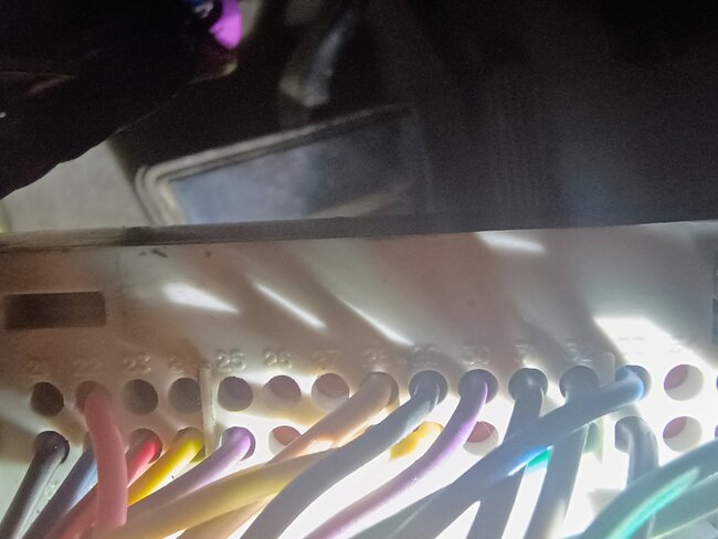

It should be taped in with them if it broke off or was a rodent snack. Or if you want to find it faster just go to the PCM under the dash and look at pin 29 on connector 1.

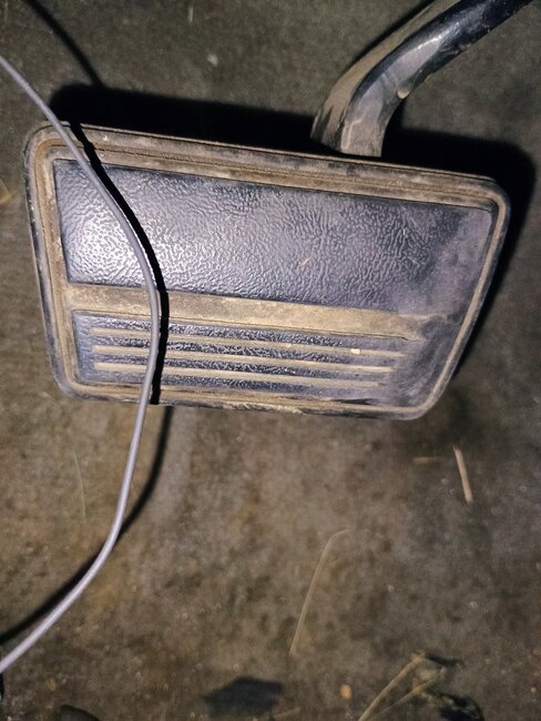

I looked under the dash and found a grayish black wire on 29, would that be correct?
Jun 25, 2025 at 10:02 AM
STEVE W.
  • 15,348 POSTS
Yes, should be a dark gray wire. Now you just need to find the same wire under the hood. They don't show any connectors so it should have been a solid wire from pin 20 out to the connector.

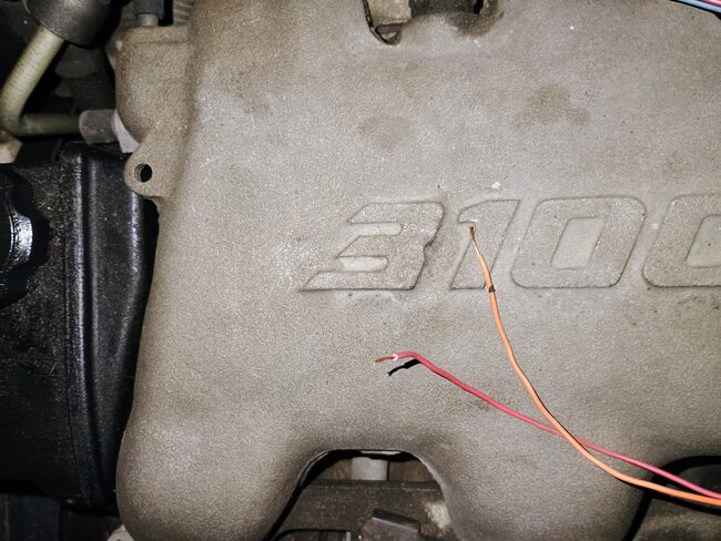

BRODYWINTERS1005
  • 11 POSTS
I never found the end of the wire but could I make a split in the wire and hook a another wire to it and then attach it to the alternator or how would I test the voltage to make sure it's the right wire so I don't mess anything up.
Jul 3, 2025 at 1:48 PM
STEVE W.
  • 15,348 POSTS
Yes you could splice a wire in for testing. Just be sure it is the gray wire in pin 29 in connector 2 on the ECM. Splice into it and just touch it to the field terminal. Put a meter on the battery and watch as you touch it, if the voltage jumps up and shows it is charging you have the repair, just make it more permanent.

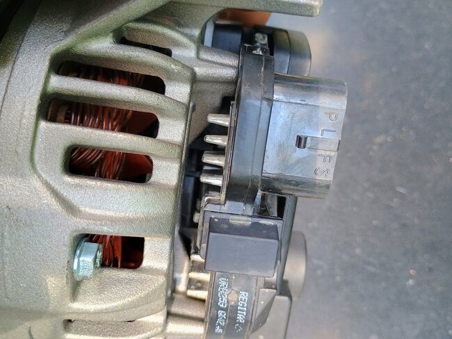

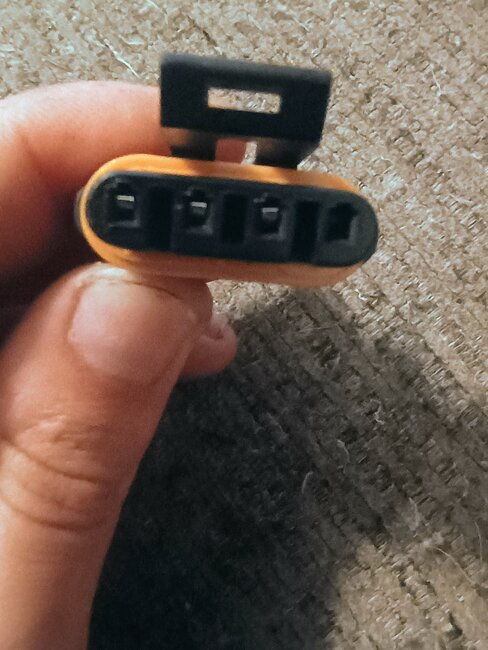

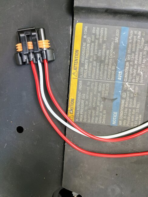

BRODYWINTERS1005
  • 11 POSTS

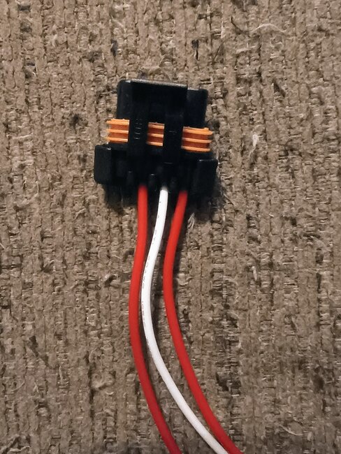

Can I attach a picture of the connector and the numbers on the alternator, so I know where I need to attach the wires to the alternator?
Jul 4, 2025 at 4:24 AM
STEVE W.
  • 15,348 POSTS

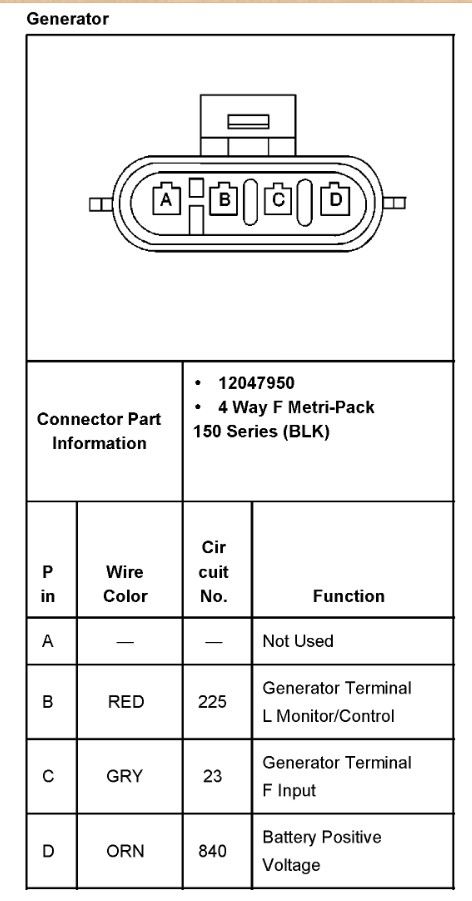

Look in the first reply and you will see the connector you have and which wire goes to which pin. Now hold the plug up against the alternator and look at the wiring diagram for which color goes to which terminal.
Jul 4, 2025 at 10:52 AM
BRODYWINTERS1005
  • 11 POSTS
I looked at it my plug wires are the other way around mine starts at a,b,c the diagram starts at b,c,d
Jul 4, 2025 at 11:14 AM
STEVE W.
  • 15,348 POSTS
It can be re-pinned. Use a thin needle to release the retainer that is inside the connector and just move the pin to the other location. Then look on the alt. and you can see the letters on the socket. P - L - F - S Yours doesn't use the P terminal. But L=B and Red wire, Then F=C and Gray wire and S=D and Orange wire. Usually those pigtails come with 4 connections and you just use the ones you need, not sure why yours only has the three, but you can just move the one to the other spot and make it work.
