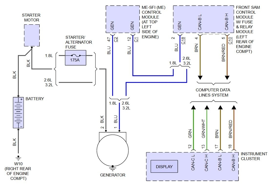

Trying to find out which terminal. does the starter wire hook to b- or b+ on alternator?

There should be a black wire that connects from the alternator to the battery terminal on the starter on terminal two. And a blue wire that connects to terminal one.

Image for above.
