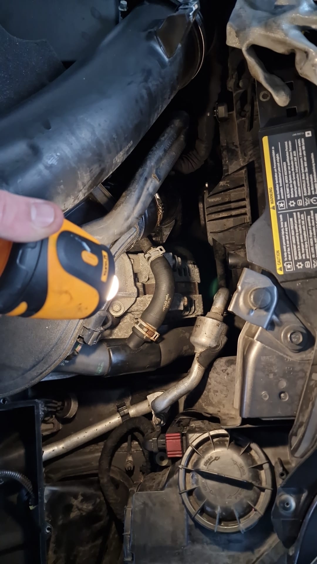

Hey, i have detached the alternator from the car engine but i can't pull it out anyone that can give me some advice on how to pull it out what to remove and what to do please Help?

Sometimes you will need to undo one or both of the engine mounts to raise the engine slightly to gain access to the alternator. Also, removing the turbo intake or exhaust tubers can help as well. Can you please upload an image so I can see what's going on, if so, I can help walk you through the repair. Did you get the belt off and did you disconnect the battery?

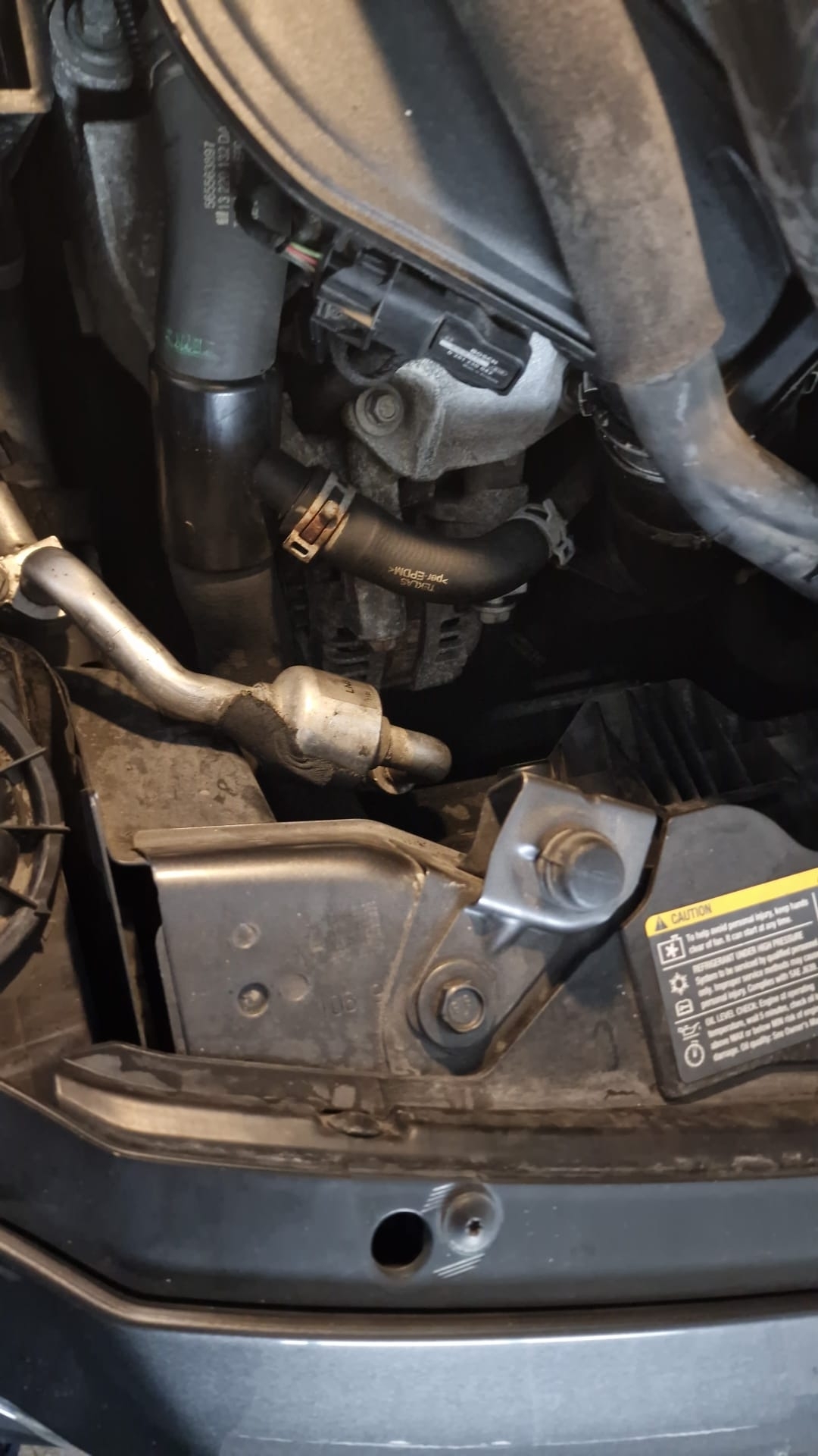

Hi Ken L, thanks for the reply i disconnected the battery removed the belt i removed the alternator from the engine i have send the pictures from the engine and from the alternator where i am working right now , the alternator is in front of the engine on the left side a removed that small hose too which is on top of alternator but i can't seem to find a way to pull it out , i thought of removing the radiator fan maybe there will be mor space or is there something i haven't tried a move that is easier. Thanks again for your time, I'll send you some other pictures too if you need them.

Yep, I would try removing the cooling fans before the radiator, just be careful not to hit the radiator with the alternator or you will cause a leak. Thanks, for the images they helped.
