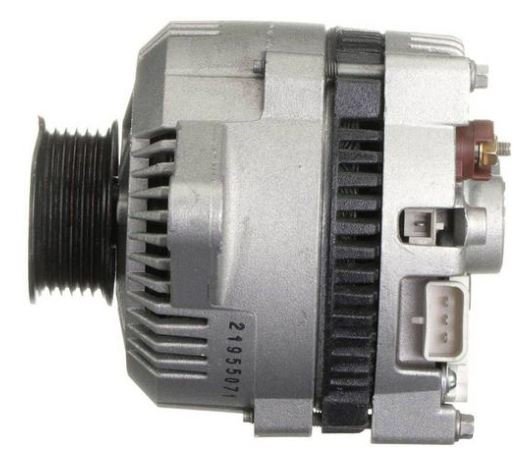

Is there different plugs? And can two prong work with four prong?

According to the wiring information, the alternator on your vehicle should have a total of three connections on it. One three wire connector, a single wire connector and a threaded output stud type connection. The replacement alternator must match this configuration.
See the attached picture below.
