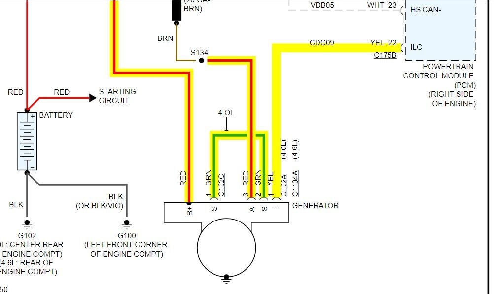

For about a year and a half now I have had a problem with my charging system.
I have been through 6 alternators.
Seem to keep blowing the voltage regulators on them.
The charging system is fine for a few weeks then I get a battery light and the charging system stops working entirely (have to replace alternator) or it becomes intermittent (off/on) and will throw the system into limp mode, or the voltage spikes
upwards of 16.50 to 17 volts on my gauge and throws the system into limp mode.
No codes, just a battery light.
This issue is driving me absolutely insane and is costing me $280.00 every time to change the alternator.
I have tried 3 different brands and the same thing keeps happening.
Please help.

Good afternoon,
These alternators should be warranty. $280.00 per time? Where are you buying these alternators?
What I am afraid of is since the voltage went so high, it may have damaged the ECM. That is what turns the regulator on and off.

The alternators I use are factory approved re-manufactured units by Wilson. From a friend that works in the automotive parts store.
I would like to add the voltage spikes only happen at a higher rev (over 4,000 to 6,000) and then go away.. sometimes normal operation resumes or I lose all charging all together. I have a new battery, no bad cells, it has been tested multiple times...
When I change the alternator the issues go away for a week to several months... How can I test the ECM?
I have tested the ECM's 12 volt supply wire to alternator field wire and it has 12 volts..
I have checked for fuses but am not finding any listings regarding an ANL fuse or likewise or even soldered in units...

It is not a fuse at all. It is all about the control of the regulator.
I would replace the ECM and the alternator together.

The ECM is delivering a consistent 12 volts to the alternator so I don't see how the ECM could be relevant?
Even if I run 12 volts from battery to alternator field wire it still will not charge...
If I change the alternator the issue goes away for a time, only to re appear eventually.
Jan 31, 2020 at 5:08 AM
The ECM controls turning on and off the regulator. It is very important in the charging system. Do not dismiss the ECM as the issue.
Applying 12 volts to the field is not a way of testing the alternator at all.
If that was the case, then the factory would have run a jumper from the big red wire to that terminal.
Jan 31, 2020 at 6:21 AM

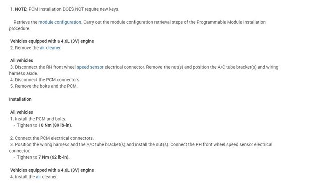

Okay, new alternator and new ECM installed.
Now I have a no start issue ? Will not start at all.
I guess the PATS system has disabled my starter etc... I now have to go through the process of having a scan tool to reset/pair the original keys to the new ECM unit?
Mar 13, 2020 at 10:32 AM
Yep. You have security issues
Do you have the IDS scan tool?
Mar 13, 2020 at 1:58 PM

I would call a locksmith and have him come to you and program the key.
Mar 13, 2020 at 2:08 PM
MATTHEWBOUX
  • 24 POSTS
The ECM needs to have the PATS system reset with a scan tool with key in on position to relearn the keys correct?
A mobile locksmith will have this type of scan tool?
Or is this a dealer only type scenario?
Mar 13, 2020 at 2:23 PM
Yes, a locksmith does have the correct scan tool.
Mar 14, 2020 at 8:26 AM

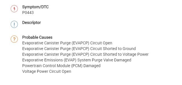

The new ECM is throwing codes that were not present before.
- PO135
- PO141
- PO155
- PO161
- PO443
The charging system is working. when cold voltage reading is 14.6 or so, and as it warms up to operation temperature it slowly drops down to 13.8 or so and holds.
I did a 1 hour test drive and have had no other issues other then the trouble codes mentions and charging system seems to be alright.
I guess time will tell...
Any other suggestions or testing that I should be doing since these new items have been installed ?

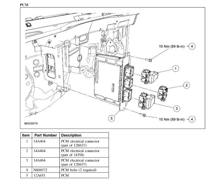

Okay, I doubt that all the O2 sensors circuits have failed at once.
Verify your connections at the new ECM.
Mar 14, 2020 at 10:51 AM
MATTHEWBOUX
  • 24 POSTS
How do I verify the connections?
They ECM has 3 big plug in ports from wire harness, all 3 have a lever latck/lock system.
The O2 sensors have never been done on this vehicle over its entire life...
So in my mind, it could be possible that the old ECM was faulty and not detecting any of these issues as well as creating issues with the charging system... causing all of these failed alternators since the initial voltage spike that happened when the first alternator initially went out.
Mar 14, 2020 at 11:31 AM
Okay, check the connectors again. Make sure that all the pins are seated and nor backing out when the connectors are latched.
Mar 14, 2020 at 11:42 AM
