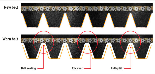

dash says alternator discharging while driving sometimes. Had alternator check off the car and it checked good.
Is there anything that controls the alternator beside the alternator? The battery is new.

How does the belt look? If it is worn it could be slipping on the pulley causing it to not charge correctly.
I will add a chart for your belt it will show you what to look for. Newer belts won't crack anymore because they are made differently. The best way is to look at the ribs themselves. It will be more like tire wear. The ribs will get smaller and smaller causing it to slip. Also, the distance between the ribs will become larger and the belt can have a glazed look to it.

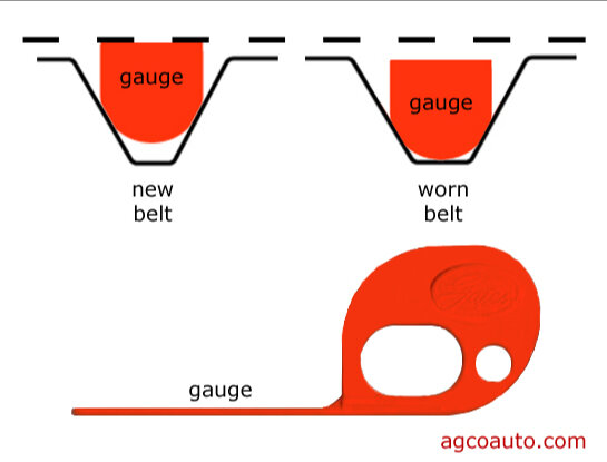

There is a little tool you can get to check it. I will add a picture of it. You can get it right at the auto parts store.
