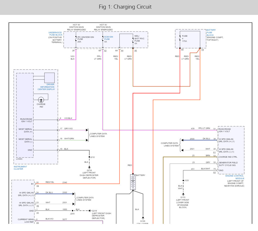

Alternator wiring where does the black cable go
2014 CHEVROLET SILVERADO
189,000 MILES
JOHN MANCILLAS

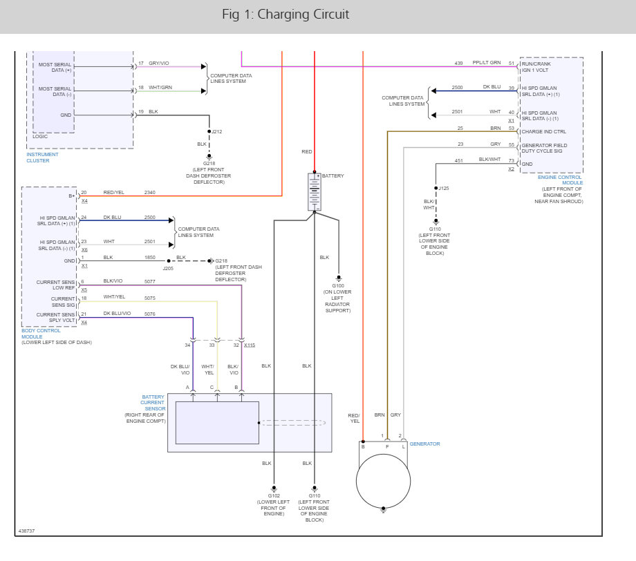

The red cable goes on top of alternator, where does the black cable go?
Sep 21, 2019 at 2:53 PM
  • 110,240 POSTS
On the alternator itself, there are no black wires. Black usually indicates a ground, but I can't say that until I know where the opposite end is attached. I attached a picture below which shows the three wires from the alternator. There is a red which has a yellow tracer on it. Here is the alternator wiring diagrams below and a guide to help testing.
