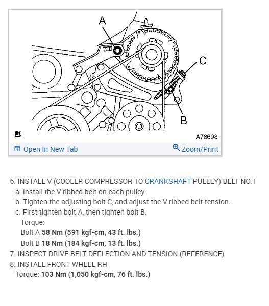

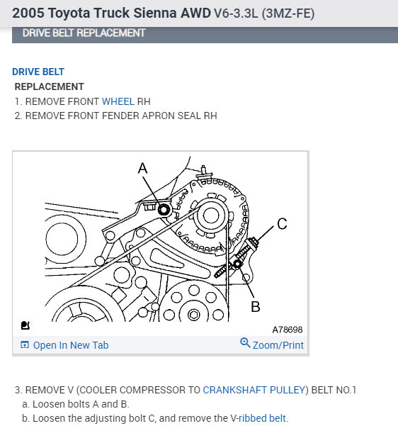

Vehicle was squeaking every time the ignition went on. Decided to replace the alternator belt. When inspecting the old belt, it's still was in good shape. But the squeaking noise continued. Should I loosen all the bolts and start again? And if yes, what are the torque specs for each bolt.

If the belt does not have proper tension, it can make the noise.
Also, the noise could be from the pulley as well. Make sure that the noise is not pulley related.
I have attached all the torque specifications below.

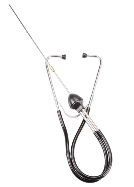

How can I inspect the pulley to know it's not the pulley?
Jan 21, 2022 at 6:15 PM
SQM
  • 6,383 POSTS
The best way to do it is to use an automotive stethoscope and hold it on the hub of the pulley. This way you are not guessing.
Jan 21, 2022 at 6:17 PM
IMAGING
  • 151 POSTS
Where is the hub of the pulley? Can you show me a picture of how to do it?

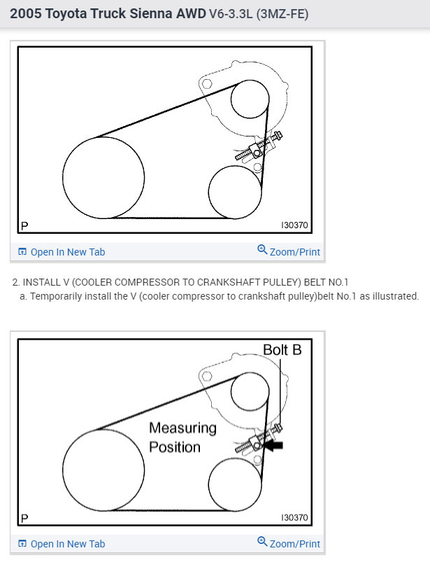

IMAGING
  • 151 POSTS

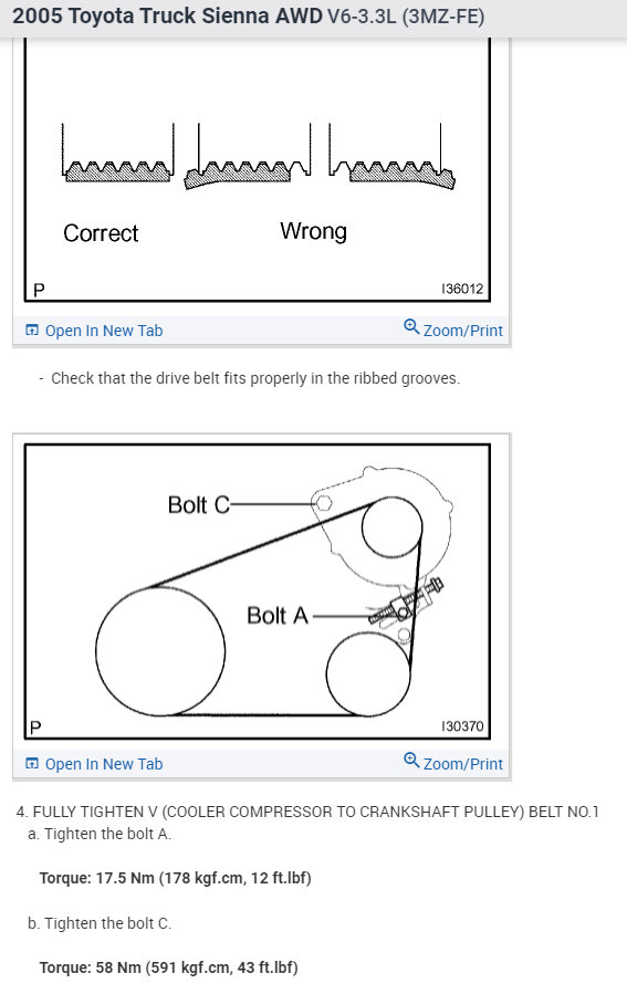

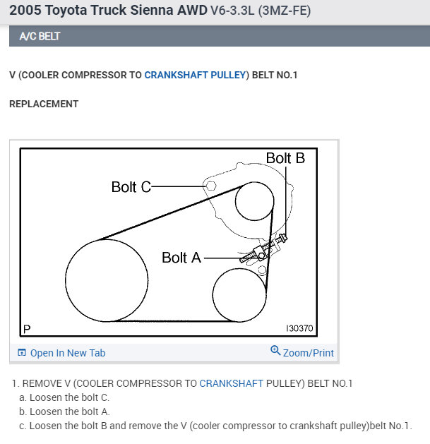

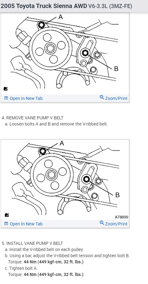

In diagram 4 (A/C belt), it shows bolt 'B' as the tensioning bolt but in diagram 5 it shows bolt 'C' as the tensioning bolt. Then it shows in diagram 4, bolt 'A' below the tensioning bolt but in diagram 5, it shows bolt 'A' on the top.
Jan 21, 2022 at 11:53 PM
SQM
  • 6,383 POSTS
I don't see those anomalies on the diagrams as you are stating.
The bolt B is the tension bolt. Bolt A secures bolt B
You first loosen the bolt A and C to adjust bolt B. Then tighten the A and C. This will keep the bolt B from moving.
