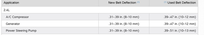

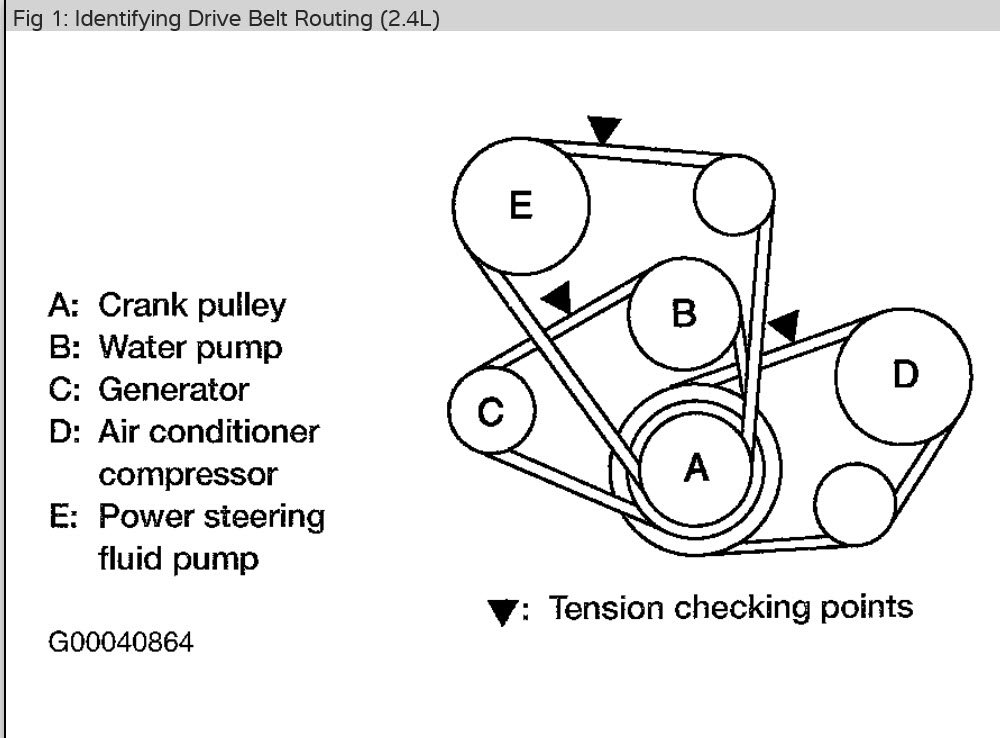

youmay be adjusting it to tight or there may be a bad pulley arrows on pic point to where adjustment should be measured see pics. this Is for a 2.4L as we don't know engine size.

It is the KA24DE motor. I have checked the tension by the book which says 1/4" to 1/2" deflection. It becomes so loose that I can turn the tension bolt by hand for about a 1/4 turn befor using the socket.

we just list motors in our manual as 2.4 or 3.0l or whatever size it is the new site doesn't give us motor sizes any longer. what I gave you is specs from Nissan. I would check pulleys then if you keep eating belts or alignment those are about the the only things that will eat a belt like yours is doing if adjustment is correct.

Would the water pump pulley be causing this even though its functioning properly? The alternator is brand new and the only other pulley is the crank shaft which the other belts are running on with no issues.

if the pulley were out of line with the other two pulleys then yes it could case the problem. a straight edge can verify belt alignment.
